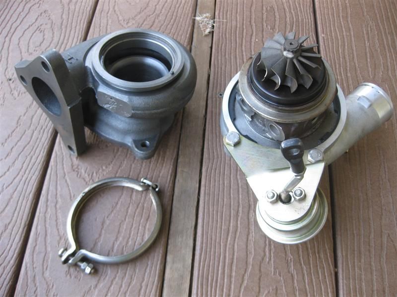

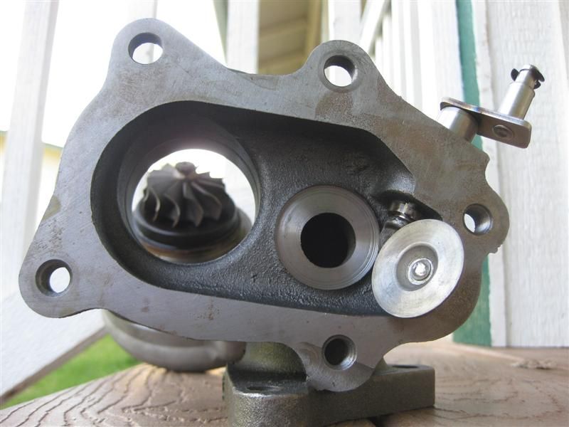

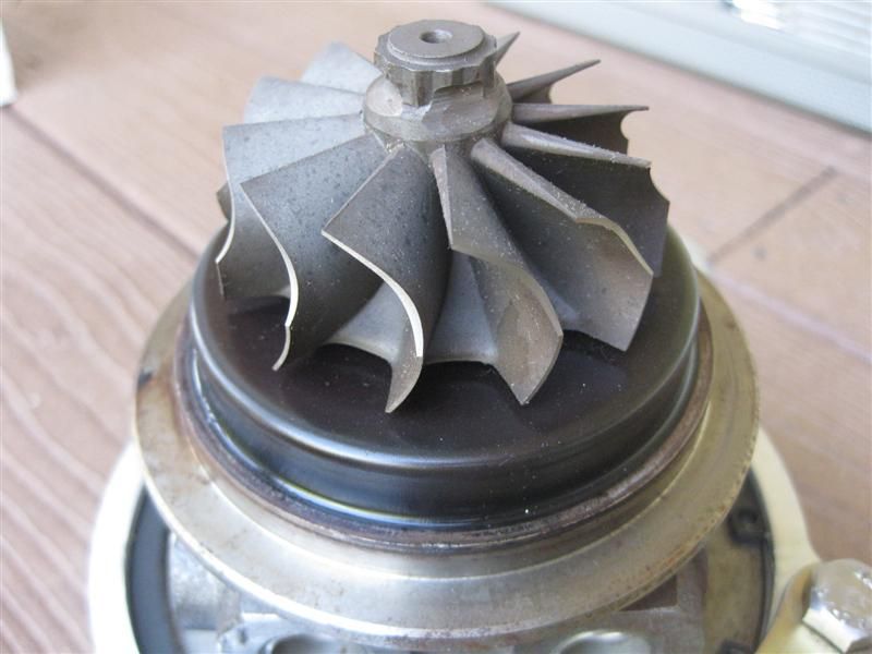

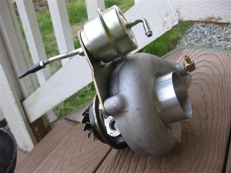

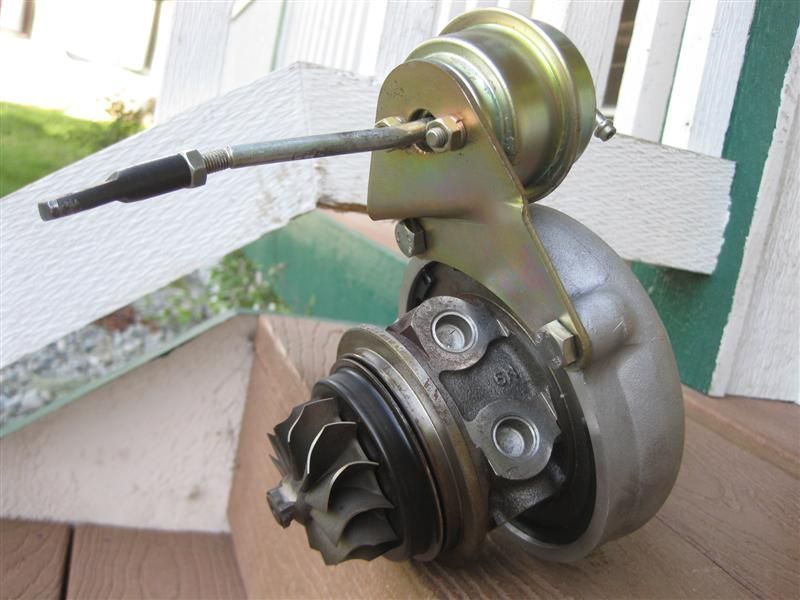

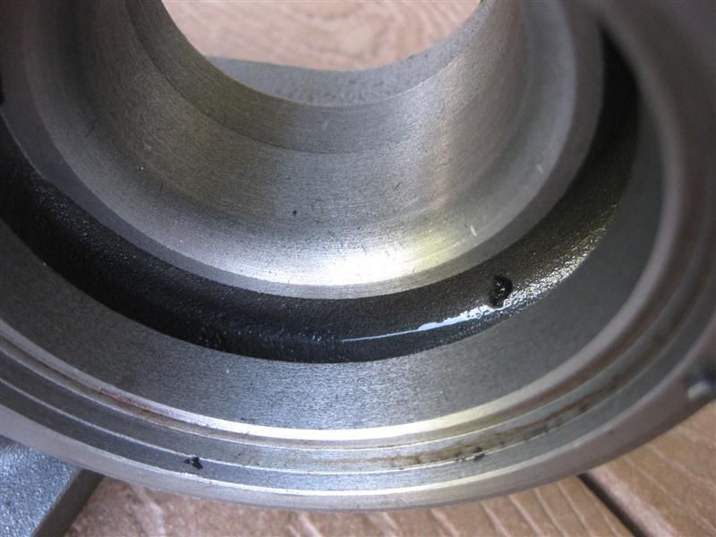

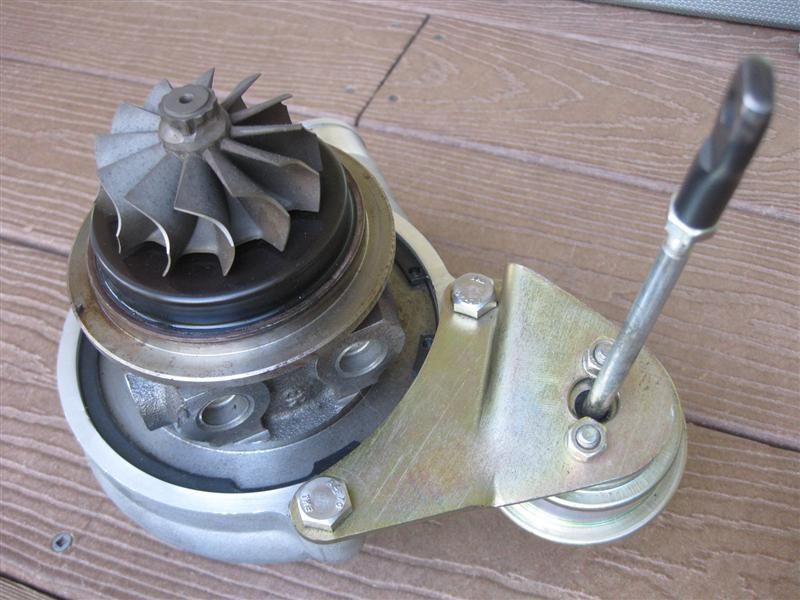

Removed the exhaust housing just now and took some nice pictures. Easiest thing in the world to do only one bolt with 2 nuts.

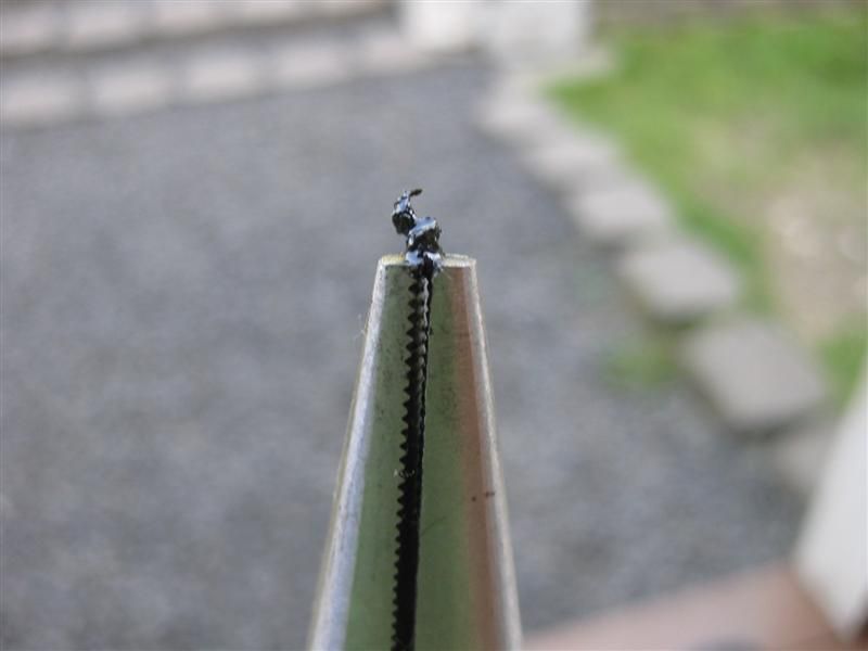

Do you guys think I should remove the cold side and have it coated as well or just leave that alone? I can see some rust on the mounting surface of the exhaust side of the turbo already starting to form. I also found a small chunk of oil soaked fabric from a rag I'm guessing in the exhausting housing and many small pieces of styrofoam inside the intake housing. Probably nothing to worry about but I'm going to remove them before reassembling.

Actually those little chunks ARE something to worry about.Imagine how little of a speck of shit it takes to wreak havoc on something when it is spinning 80,000 rpm!
Re: Is it difficult to take apart a turbo?
Interesting, even the styrofoam? Crazy. Well good thing I took it apart then.

I wonder if I removed the compressor housing and both wheels if I could get them to mask off the shaft and the ends and coat the center section without having to fully disassemble it.

nice pix Kimo!

Personally, I wouldn't worry about the center housing and the little bit of rust that is starting. Turbos are made out of steel, iron, and aluminum. Steel and iron rust, and its part of life. If you resale is affected that much by normal processes that act upon a turbo, you a trying to sell it to the wrong people. What actually counts is the shape the wheels and bearings are in, not how pretty the housings are.
If those bits in the exhaust housing are foam, its not the end of the world. If they were metal, that could cause an issue if they went through the turbine wheel under load. I've seen what happens when a crappy flex joint gives out and rips up a turbine wheel, and its not the prettiest.
Also, if you are coating the exhaust housing, I would clean up the casting flash with some sort of abrasive to make it smooth.
