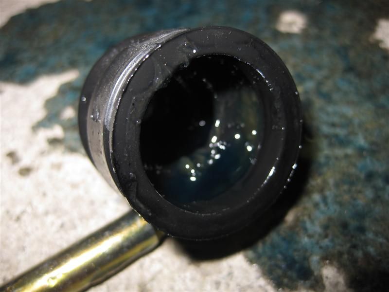

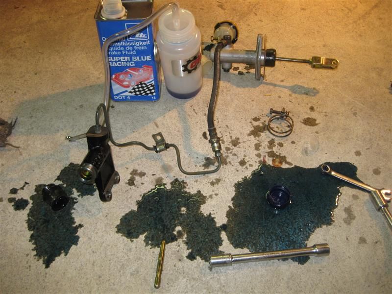

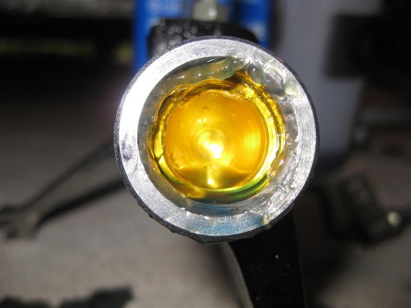

I tried bleeding the clutch system today out of the vehicle. That was a bad idea. I feel stupid now. I now need to know what kind of grease I need to use to put in the slave cylinder boot as it's all gone now...
I filled up the reservoir and then pumped the MC and the reservoir started to empty so I opened it back up and filled it again and started pumping and then I heard a hissing noise coming from the SC and realized it had pushed the plunger all the way out and was leaking brake fluid on the floor through the boot. I hadn't cracked the bleeder screw yet. I pulled the boot off and all the grease inside was mixed with brake fluid so I wiped it all out. Anybody know what kind of grease that is? Do I just stick a bunch in there and put the boot back on and call it good?
Next time I'll just bleed it on the car. Stupid.

Yes there is enough grease left,don't sweat it.And on a side note,dont bother wasting your sweet racing fluid on the clutch hydraulics,your slave cylinder doesn't get 1000 degrees like a race car caliper does. :lol:

What's your middle name, BP? You got your own spill going on there!
Now is a good time to replace the bleeder nipple with a Speed Bleeder.

I tried finding a damn speed bleeder yesterday! What a waste of time that shit was. Anybody know the size and thread pitch of it? I went to 2 autozones, 1 napa, cute rate and then I gave up. Got tired of driving all over town when every store stocks like 2 sizes of speed bleeders.
You sure there's enough grease in there? There's no grease left in the boot or the the end of the cylinder. I figured there wouldn't be any inside because of the brake fluid in there but maybe it's compatible with the brake fluid?

Of the few that i have taken apart there was no grease at all :wink:

Those were all used I'm assuming? Did I mention the old slave cylinder was completely rusted and froze up? So not only was the MC seals gone but the SC was toast too. I should stick it in some malt vinegar and see if I it'll remove all the rust!
