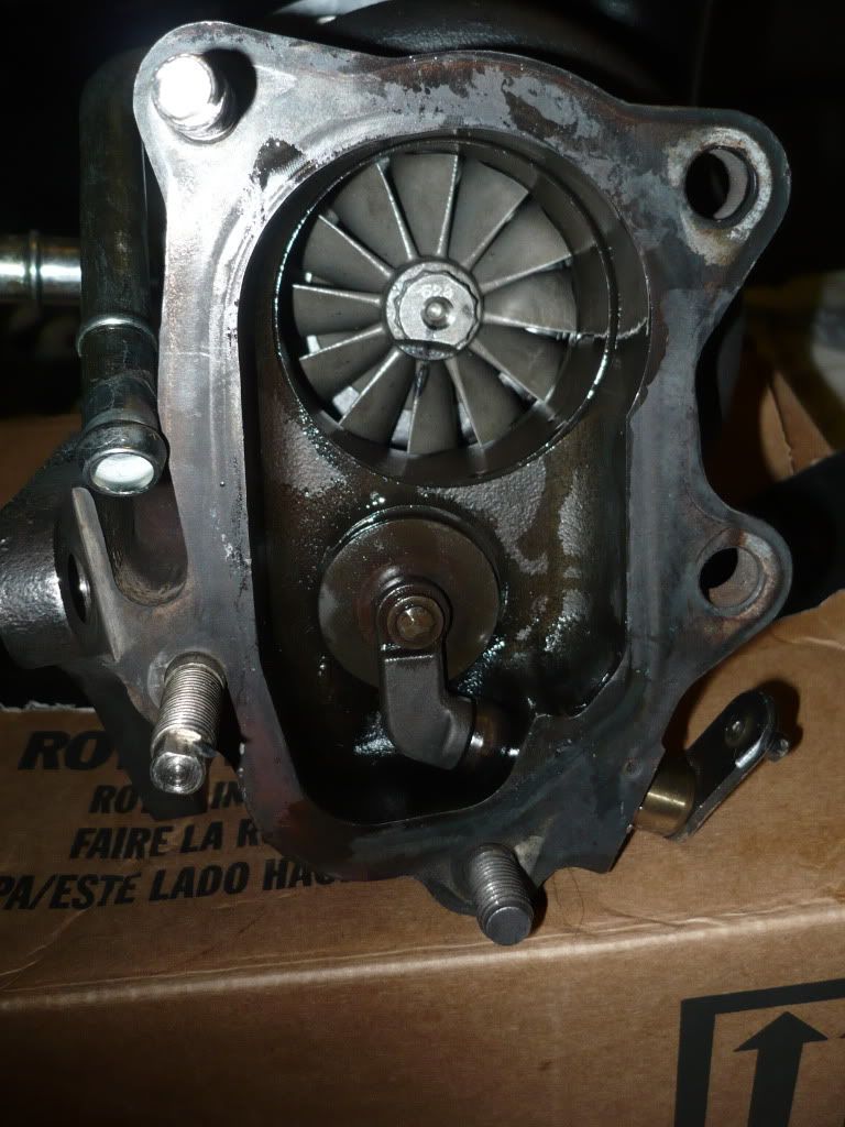

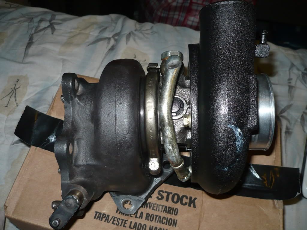

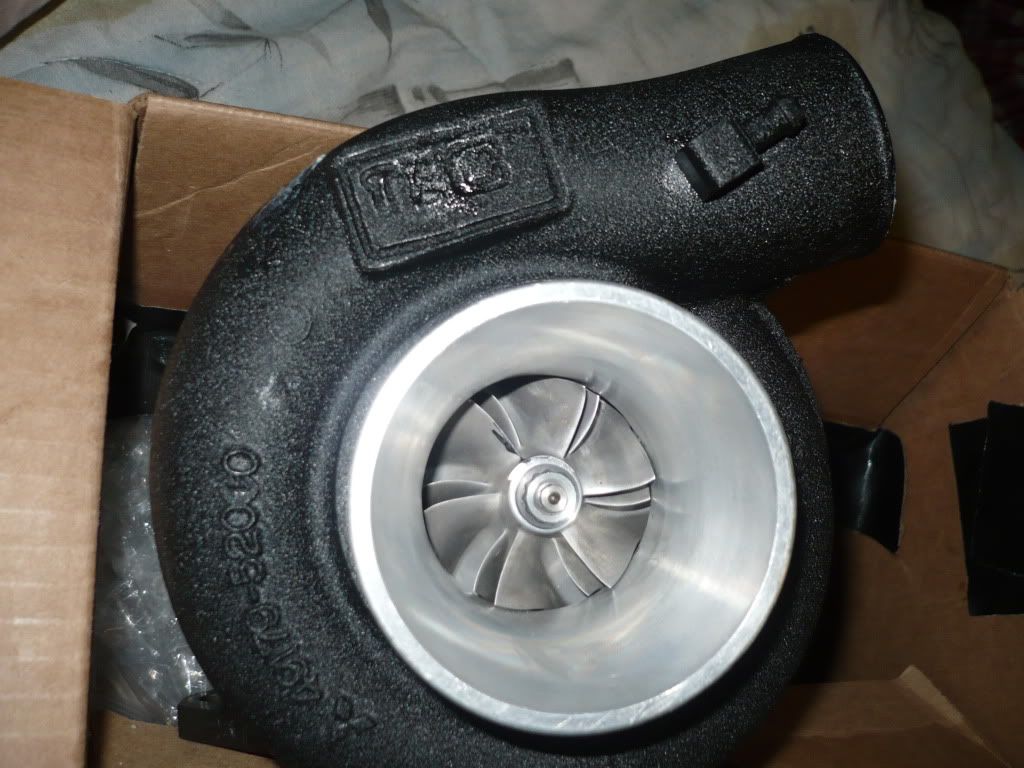

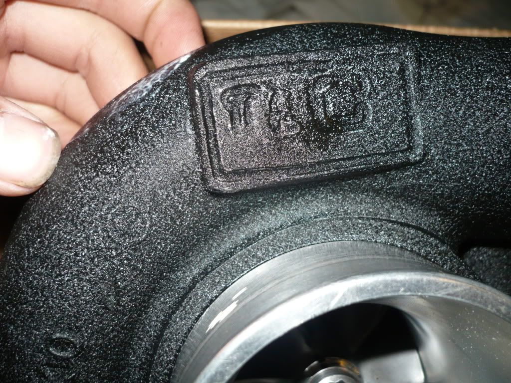

Ok, but there are no other turbos in my town sold locally right now. I think ill just buy it and keep it since its been overhauled (thrust bearings, seals and journal bearings) and is in like new condition. $500 bucks for a $1200 turbo i cant pass it up. And its a TEC turbo too. Just so it can be exploited more when i change out the heads.
also do 02-07 wrx/sti fuel pump kits work for our cars? If so i want to buy this. I want to go with a walbro 255lph pump, what fuel pressure should the regulator set at for running 880cc's? ps im going with power enterprise side feeds.
http://cgi.ebay.com/ebaymotors/WALBRO-2 ... ccessories
Also this 6puck Comp clutch also so save on shipping. It says its for a 02-05 wrx, but on other clutches it says it works for both applications on the ss and wrx. Is that true? Also its going to be paired with a steel Exedy 12lbs flywheel $183cnd new.
THANKS!
http://cgi.ebay.com/ebaymotors/STAGE-4- ... ccessories
