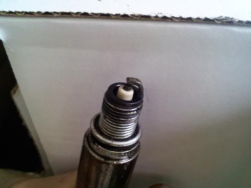

Test the resistance of the "dead" wire and compare it to the others. Also, pull the plug and see what it looks like, black and sooty or white and ashy looking.

Legacy777 wrote:Test the resistance of the "dead" wire and compare it to the others. Also, pull the plug and see what it looks like, black and sooty or white and ashy looking.
The spark plug still looks fairly new, not black or white. You can view it at my photobucket link below.

Wow that spark plug looks a little too new lol

It's cause it's about/less than 4 months old. Though the fact that it shows so little wear makes me question it a lil too. I am waiting on a friend of mine to help me do a compression test so I can rule out the cylinder being faulty instead of wires or sensors.

I'd imagine a spark plug would look new if it never fired and only ever saw air and raw fuel. The fuel would keep it clean, in fact!
