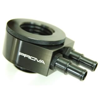

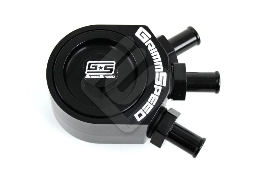

Re: Best Catch Can/ Oil Seperator Set-ups
I read over on NASIOC that oil entering the intake is the cause of some knock problems due to oil vapors raising the cylinder temps too high. This has me interested in setting up a system but I wouldn't bother with the catch can because it makes a lot more sense to use a separator that condenses oil vapor into liquid and returns it to the system. Problem with that is they're expensive as hell and for what it is, it should not be that expensive. Makes me angry.
$420 Prova Air/Oil Separator
http://www.rallysportdirect.com/Prova-A ... 11-WRX-STI
$300 GrimmSpeed Air/Oil Separator
http://www.grimmspeed.com/catalog/produ ... cts_id=191
