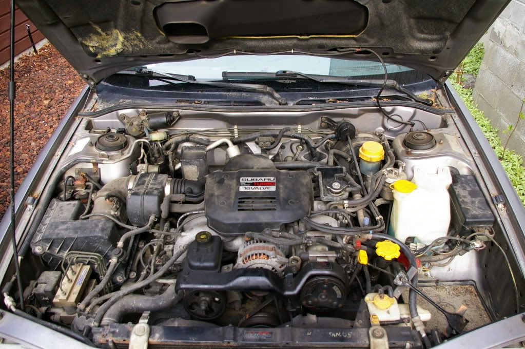

Had a nasty sound that was either broken flex plate, lifters, or something deeper in the engine (sound came from everywhere so was hard to distinguish)

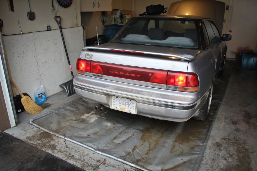

Well here is how it sat when I got it home 80km later.
Car was poorly maintained so I had some work on my hands. Did the usual things like plugs, wires, new front rotors (powerslots) and pads, new struts all around and removed all the stickers plastered on every single window (ugh kids). The engine noise still persisted but the car drove fine without a problem. I seriously thought it was the flexplate but because I planned on a 5spd swap I didn't worry about it too much. Well one day it just didn't want to start, checked that it was getting fuel and spark and was cranking fine. Finally a good mechanic friend of mine mentioned to check the timing. So I did and sure enough the noise this entire time was an idler pulley. It had completely separated and all the bearings were everywhere within the timing covers. So replaced the belt, all the pulleys, new waterpump (while im in there) and boom car fires up and no more noise!!! (also very happy these are non interference engines).

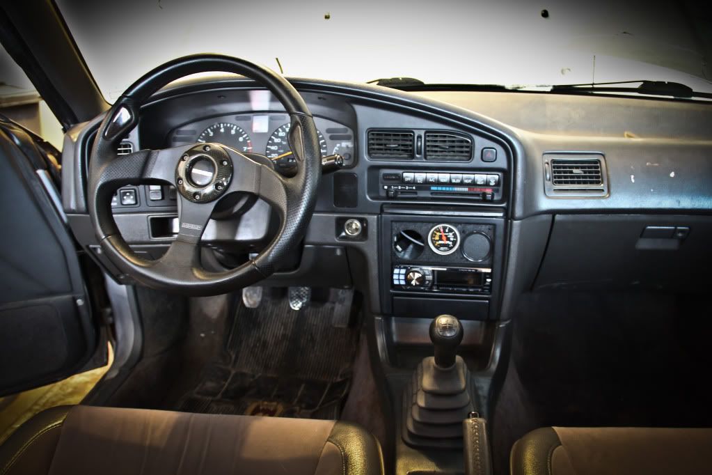

With that it was time to install a boost gauge and my Momo Jet wheel that was in my summer car. Also got a set of euro tails to replace my broken tails.

Car looks great. I like your gauge set up. What shift knob is that?
I'm jealous of all that snow too!

The shift knob was from an earlier style Outback and I would imagine you have snow being from Alaska! Or is it too cold that it doesn't even snow?!!

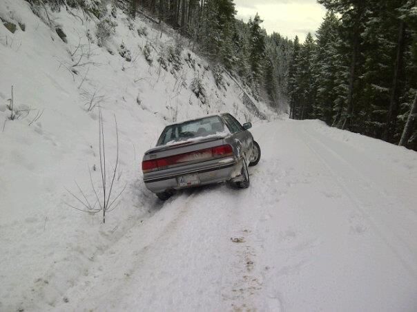

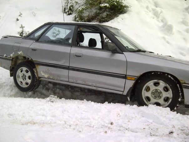

well it's been a while since I last had any fun excursions in the Tleg but the past few days I treated a summer of neglect by driving it on some snowy roads! Once again I found the ditch to be too irresistible to pass up. However being a Tleg it didn't take much time to blast back out.
I didn't really cut the corner that much, but it was enough to get sucked in.
And after a bit if digging and rocking back and forth we got the Tleg poised on three wheels ready to blast out of the ditch.
