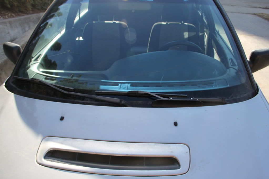

Here is a very simple DIY on making a wiper arm spoiler for your Legacy (and probably anything else). I got the idea whilst I was looking around a wrecking yard. I took a look at an older gen Honda Accord and compared the wiper to a BC Legacy that was also in the yard. Below are the parts needed and the steps I took to make it. Total build time ~5 min.

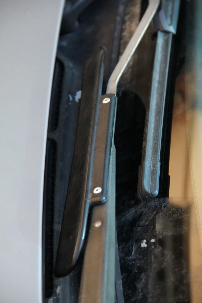

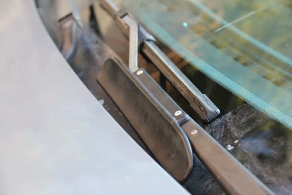

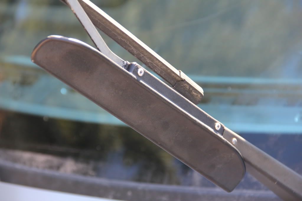

step 1) Line up the spoiler on the Legacy wiper arm as shown in the picture below. As you can see I chose to put it right at the end of the thicker part of the arm.
step 2) Mark where you are going to drill on the wiper arm (I did this by drilling through the wiper spoiler hole while holding it where I wanted it). Drill all the way through the wiper arm
step 3) Repeat for the second hole making sure the first one remains lined up. Easiest thing is to put the first rivet in already.
Step 4) Mount your new wiper arm with spoiler to car! Yep it's that easy!
Fits perfectly and doesn't interfere with anything. If you are able to I recommend getting black rivets. Now you will be able to see in the rain without having your wipers skip or chatter!
