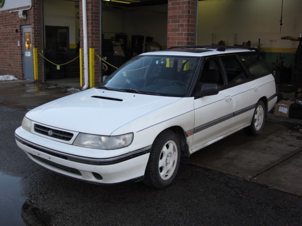

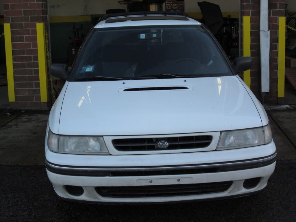

Hey everyone. This is my first Subaru and my first Subaru swap. I have a 1994 Legacy Touring Wagon. I just picked up a motor, trans, etc from a rolled 2004 Sti on Sunday. I will be slowly building the motor and transmission while it is out. Once I finish building it with simple bolt-ons, I will drop it in my wagon. My goal for now is to get 300-350 whp. Hopefully I can reach this goal without blowing anything up. i will try my best to have diys with pictures of my progress. All are welcome to voice their opinion or offer any advice while im tackling this project.
Here's a few pics of what my car looked like when i first bought it. I got a set of used 6 spoke wheels and painted them white.

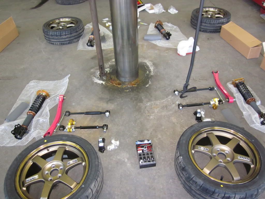

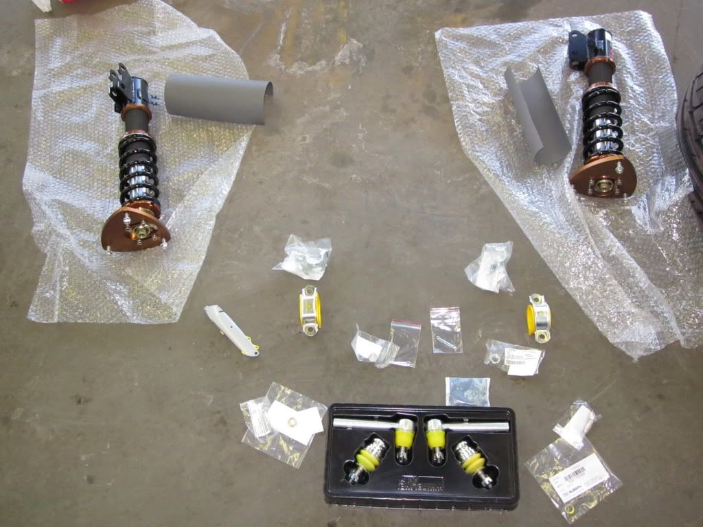

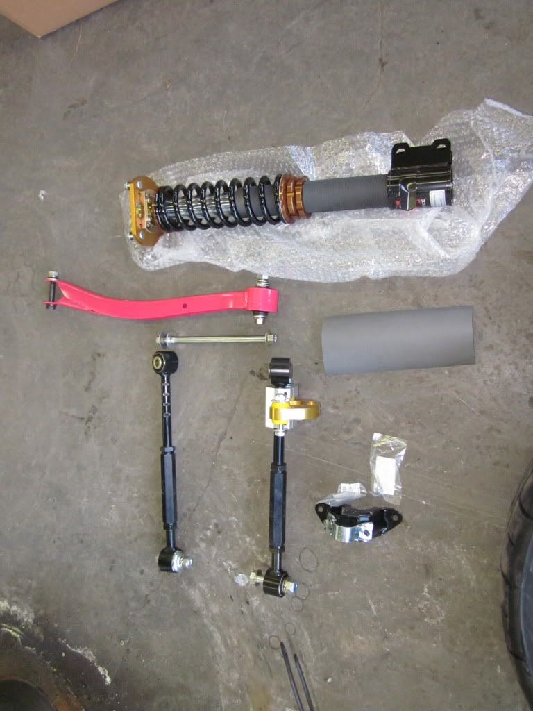

List of Suspension Parts i bought for my car:
Stance GR+ coilovers (used GC8 rear top hats)
SPC rear lateral links
Aluminum Control Arms
Sti pink rear trailing arms
WRX rear sway bar mounts
all new oem subaru bolts
Ebay Front and rear strut tower bars (GC8)
Anti-Lift Kit: KCA319A – Whiteline Anti-lift/caster kit - lwr c/arm
Steering Rack Mounts: KSR202 – Whiteline Heavy duty steer rack mounts (30mm)
Front Sway Bar: BSF18X – Whiteline Swaybar 22mm-X heavy duty
Rear Sway Bar: BSR19XXZ – Whiteline Swaybar 22mm-XX h/duty Blade adjustable
Front Sway Bar End Links: KLC139 - Whiteline Sway bar link kit-h/duty adj steel ball
Rear Sway Bar End Links: KLC26 – Whiteline Sway bar link conv kit - extra h/d alloy
Toe Lock Kit: KCA377 - Whiteline Toe lock kit
Outer tie rods/ lower ball joint: KCA313 - Whiteline Roll-centre / bump-steer adjust kit
Front Control Arm Inner Bushing: W51709 – Whiteline Front Control Arm Lower Inner Front
Rear Trailing Arm Bushings: W61383 – Whiteline Lower Rear Trailing Arm Bushing
Leggdura Racing lug nuts
Volk TE37 17 x 7.5 +44 offset
Dunlop Direzza Star Spec Tires 215/45/17
When i took these pics, half the stuff was on special order from Austraila... 2 month wait =(

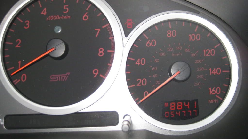

Today i got some good/bad news. Just to let everyone know, I am a noob when it comes to Subarus, so you guys can yell at me all day long if you like. Anyways... When i bought the swap the guy told me it was out of a 2004 sti.
Obviously I dont know what to look for, so i just made sure the block said ej257, and the trans was a six speed, etc. I found out today that the motor and trans are actually from a 2005 sti, even though the title, vin matched up (title said 2004). I did not know that an 04 sti motor was still a throttle cabled motor. The motor i purchased was a drive by wire system. Luckily, I had the pedals, and all the body wiring included.
The crazy thing though is that the spindle/hubs are 5x100. So i am guessing that this was like a halfway point when they started throwing the 05 sti engine/trans into the 04 chassis?? oh well no turning back now. lol.
This is going to be more fun than I expected... sigh...
