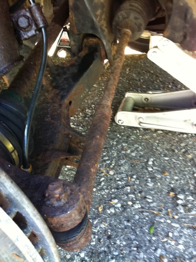

when i got it
yummy rust
bad shot at night with sti front springs and stock rear springs
