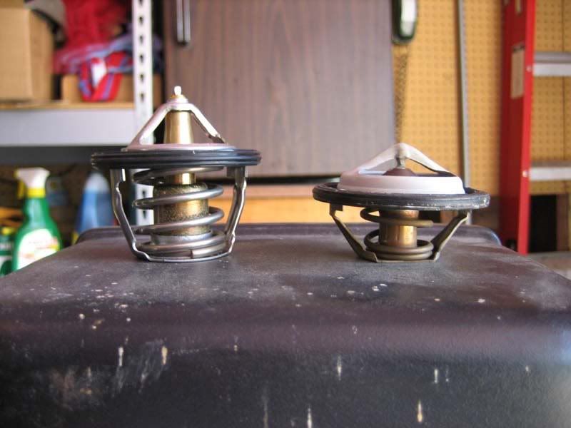

People hate them for a reason. They're built wrong. Stop being cheap and use the OEM subaru thermostat. If you had the OEM one sitting next to an aftermarket one you'd notice the difference immediately.

Found a picture comparing the two. OEM on the left, aftermarket on the right.
Re: COOLING SYSTEM HELP!!!!!!! URGENT!
Wow big difference
Indeed, it's no wonder they don't work properly.
And the price really isn't far off, either. People are afraid of the dealer's parts department, but the prices on some things are very reasonable so it doesn't hurt to check there first.
I'm not sure it's really an issue of the aftermarket unit failing so much as failing to work with these engines. I tried one myself and had issues. When I checked it in hot water and let it cool off, it cycled appropriately, but caused problems while installed. Went and bought an OEM one because of the obvious difference in size and quality (which I didn't know until I bought the aftermarket unit and removed the old one) and that was the end of my thermostat problem.

Wow, that is a big difference on the thermostat. I guess i'll go pick one up from the dealer on wed. when i get paid.... Its so weird though, my last thermostat was a stant and it worked perfectly for over a year. maybe they are just not built to last or something...

Just to add a little more info, the aftermarket thermostats respond different to rates of temperature change than the stock setups. They tend to respond more quickly so you'll get temp spikes or drops. I first experienced this phenomena with the aftermarket t-stats back around 1995. I replaced the t-stat with an OEM Subaru t-stat and it was fine.
kimokalihi wrote:Found a picture comparing the two. OEM on the left, aftermarket on the right.
That garage looks oddly familiar. ;)
LOL you caught me red handed! At least I didn't say it was my picture. :)
Hey, spread the word. I was giving you a little crap. For four years I've hoped that pic would go viral in the Subaru community. It needs to be known......
