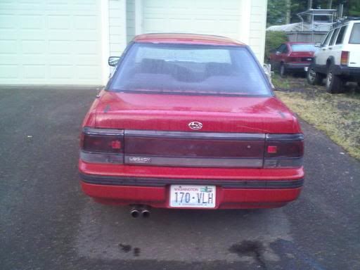

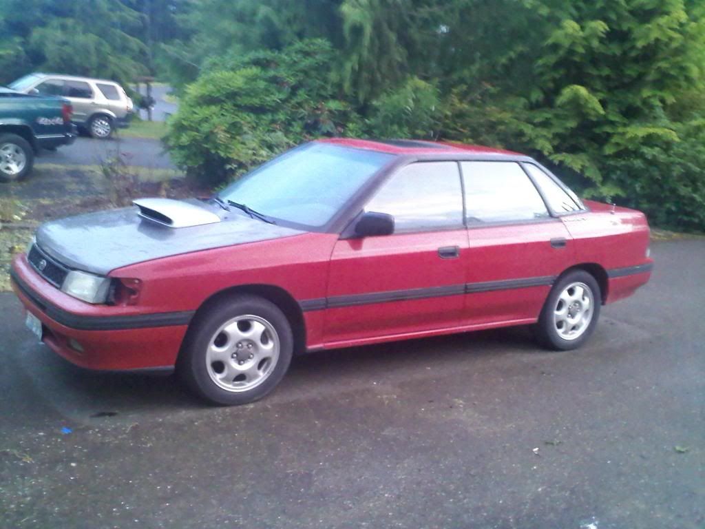

For your viewing pleasure. My new (to me) 91 SS. 250k, tmic, wrx turbo back exhaust, wrx hood, kn filter, and short throw shifter.
I personally dont like the hood scoop, but Im stuck with it for the time being.....
What do you guys think this is worth? Runs flawless, but has pretty high miles, and isnt that "good looking" as the PO said.
He gave me a new turn signal, I just havent put it on yet. As well as a speedo cable, as it broke last week

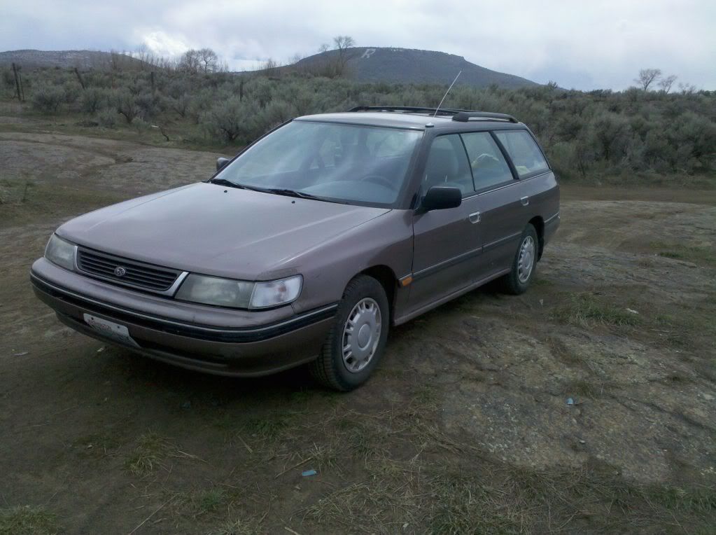

And here is the 93 n/a I am having the issue with.
