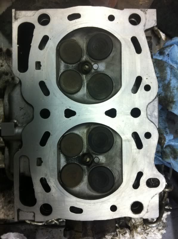

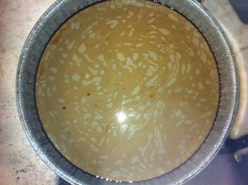

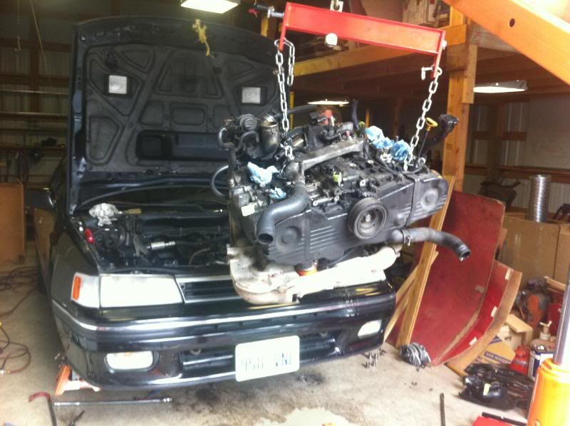

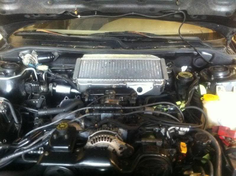

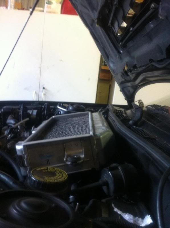

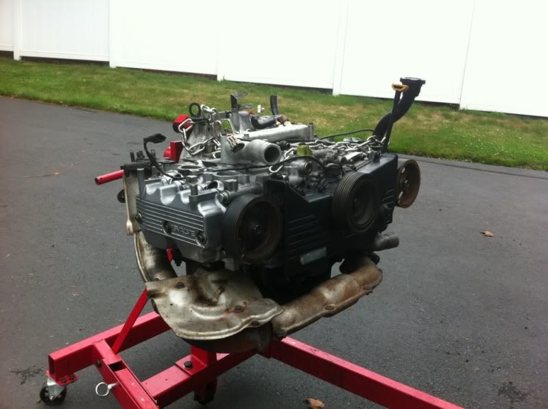

Yeah I planned on rebuilding the heads. Here a few pics from over the last couple of days
The day I picked it up (camera phone crappy pics).
Getting close.
MMMM milk shake coolant!
She's out!
Then I hit a snag.... On the drive up to the shop the car started to make a horrible noise. I had an idea what it was since I have encountered it on my VW bus. The bus's was only cracked.
The new one will be here hopefully in a week. The new flex plate only cost 60 bucks (that includes shipping and tax) from 1stsubaruparts.com. The local dealer wanted 100

well the head gaskets look good :/. The only other place it could mix is in the turbo. The turbo is wet with oil and has some pooling in it. I am hoping it is the turbo if not I will have to split the case and have it checked for cracks. I could not see any visible cracks.

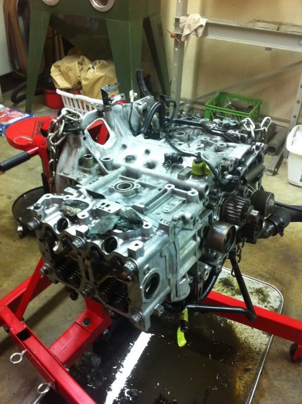

Post by Mister Anderson »
Just an update. I got the new drive plate Friday morning. I won't be able to go pick the cams up until Tuesday morning since I have to work. I went ahead and got the 230 instead of the 220. Here are some pics of the progress.
I still have a little more cleaning on the engine.

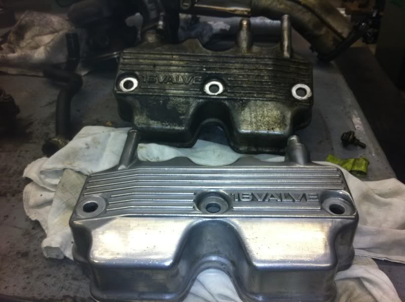

Ready to go in. Yeah I am positive it was the oil cooler. There was oil in the coolant side of it. I wont be able to start the car until next week since I am waiting for my TD04 turbo and intercooler to come in. That all should be here on Wednesday.

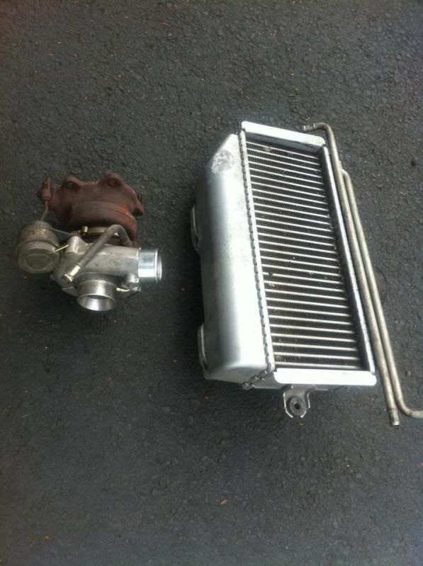

Just an update.
I media blasted the IC so I still need to repaint it. The turbo is also installed now. All I am waiting for is my silicone intake tubing to come in. I also got a AEM tru boost setup
