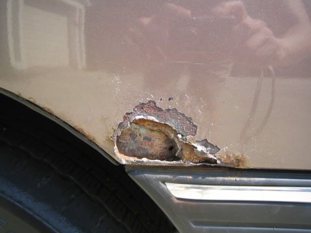

The "Misty Dawn" paint was in amazing condition for its age except for one total rot-through on the rear quarterpanel (This is after I peeled away the paint-scab that hid the corrosion).
There was a gob of mud that was stuck in the fender and it trapped water against the sheetmetal. Over time it formed a pinhole, and what water that made it in got stuck along the rubber adhesive material the factory used in there.
I put off fixing the hole until right before I left town, even though I had almost a month to get around to doing it. The average summer temperature here has been about 98degrees and 80% humidity- hours after I decided to getting around to dealing with the car it started to rain, and the forecast predicted that it wouldn't let up for days.

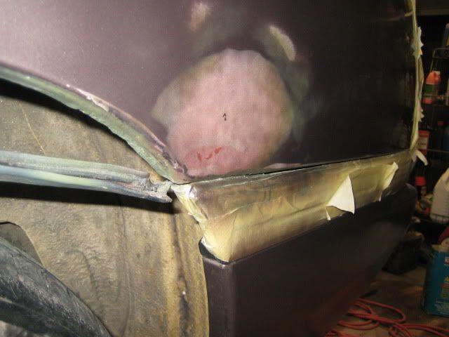

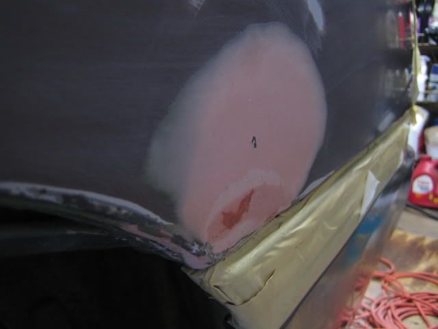

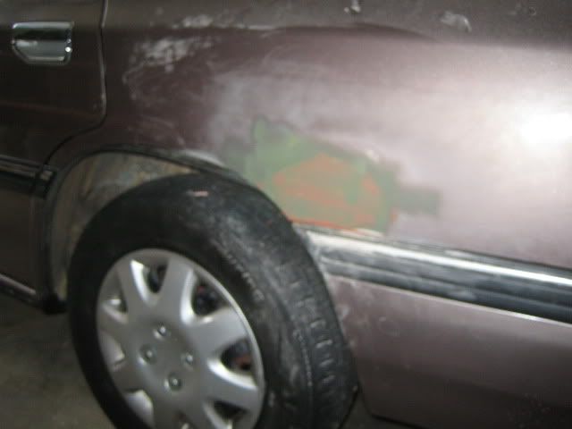

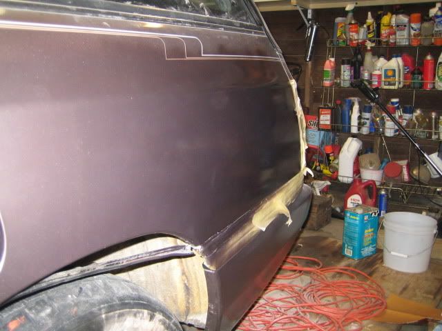

I sprayed as many surfaces I could reach with rust preventer or self etching primer, then let it dry for 4 hours, plugged any holes, then put in the base layer of bondo. The panel has a fairly flat contour so it was easy to sand down with a block.
The lower edge of the panel was heavily corroded and needed to be "rebuilt" so I began to take off the bumper to gain access to that edge. I accessed one exterior bolt and the clip nut it was attached to, and in the process of ripping out the interior panels I realized it is probably easier to pull the engine with a spoon than it is to take off the rear bumper.
Enter the laziness!
Since the top leading 3" edge of bumper was free to wiggle, I slid some 220 grit between the bumper and the quarterpanel and just shook the hell out of it until it shaped the bondo into what I thought would be passable.
It worked OK, and the throttling motion helped channel some of the aggression I held from trying to remove the bumper.
I did the sand and prime dance with 600 grit a few more times, and then when it came time to mask I only did the plastic trim. Yes, again with the laziness, but I also figured the paint was going to look so off that any overspray would help blend the color.

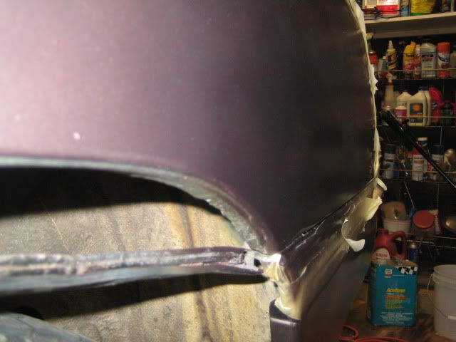

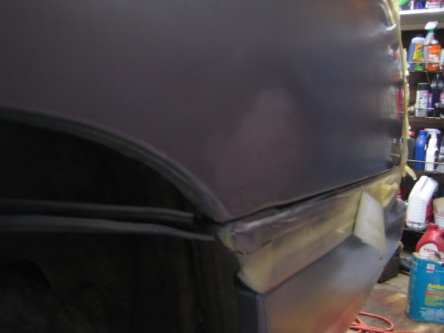

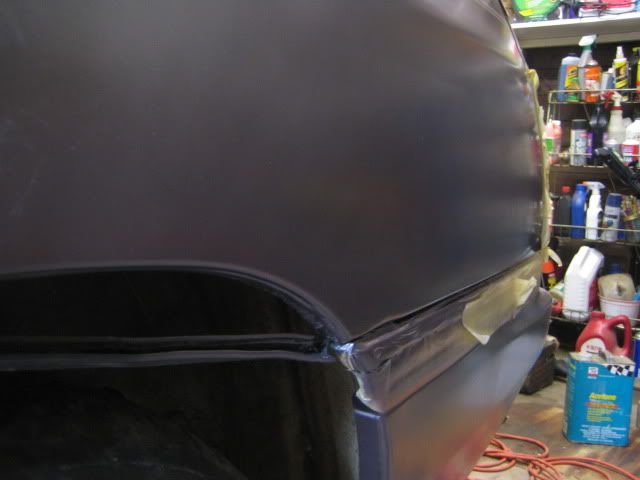

I had ordered a can each of "059 Misty Dawn" and the matching clearcoat from autmotivetouchup.com. It's basically a metallic beige with a little bit of burgundy to it. I've used metallic rattlecan from duplicolor in the past (pearl blue on a Buick) and it looked like total crap, but I have to say that I was surprised with the results with the Subaru:

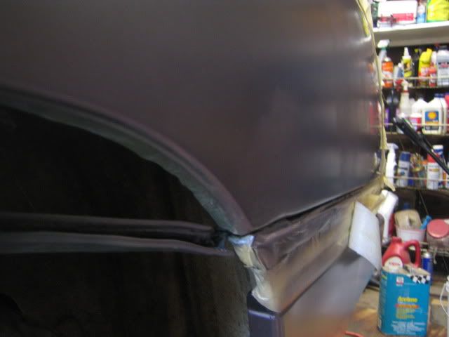

First coat-super light :
Second coat:
Third coat:
Fourth coat:

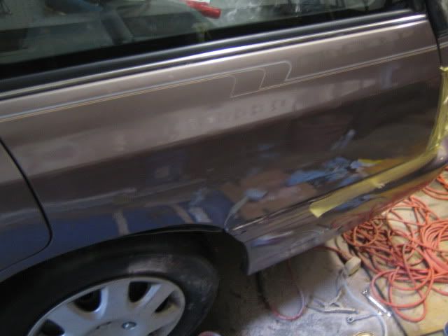

First clear coat:
Second clear coat:
There may have been a fifth coat of base color; some of the coats were so lighty applied to blend that I didn't really count them as a coat.

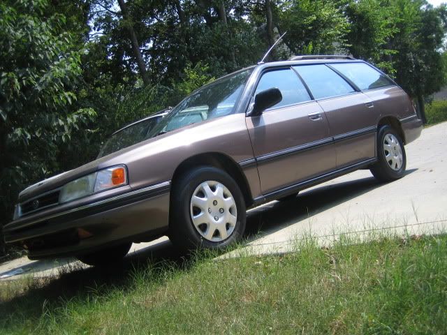

The wagon is still in the garage and will stay there for another 24 rainy hours in an attempt to let the paint dry adequately in absolutely awful painting conditions. Here is how it looks now:

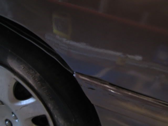

I tried to touch up a chip in the door edge and thought I screwed everything up when I wiped down the door with acetone. The edge of my rag swiped some of the quarter panel paint and made a small but really noticeable blemish in the fresh paint.
I just crossed my fingers and hit it with a coat of clear hoping that it would make it less noticeable. The clear actually pulled up some of the color (metal flake and all) of the base and it all redistributed it in an even coat, thus totally erasing my mistake. I thought it was fairly amazing at the time, but realize now that I had also spent several hours in a cloud of rattle-can vapor
