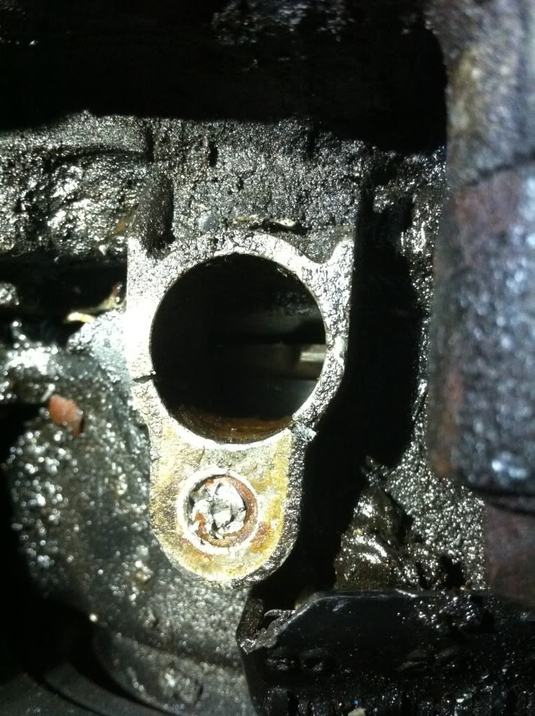

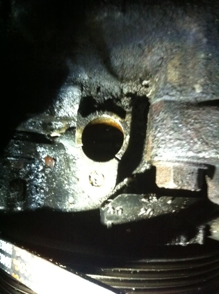

hey guys went to the junk yard and picked up a new cam angle sensor got back home tried to take mine off and the blot snapped bout 1/4'' down... awesome i thought no big deal just pb blast it and use a puller tomorrow.
Then i go to take the sensor out and it also snaps in half, now I'm totally Fu&*ed. looks like its never been changed and basically "welded" i guess would be the term in there by all kinds of nasty crap.
How the heck am i gonna get it out? Seriously terrible day because of this.
Im trying to avoid having to take the timing cover off because i don't have the tools to retighten the cam pulley or the extra arm

Unless someone has another idea, I think removing the cam pulley would be the only way that I can think of doing it.
Re: cam angle sensor HELP!!!!!!!!!!!!!!!!
Don't feel too bad, you're not the only one that has had this happen. It happened to me a couple years ago, and I remember reading on here that it happened to some others also.
I don't remember exactly what I did, but I did not remove the cam pulley or anything that involved. Have you taken the timing cover off on that side? You might gain enough access to get a screwdriver or something in there and hammer out whats left. I'm thinking that's what I did?
Good luck, hope this helps!
lucas wrote:Botched that one correction crank angle sensor
Hahaha, I find that that funny cuz right after I posted that I realized it was the crank sensor that broke apart on me! lol
But in that case, if you have a tiny screwdriver or pick you can get in there between the sensor body and the hole and then pry on it, then take some needle nose pliers and give a twist it may come out that way.
Probably need to remove the alternator to gain some decent access to it too.

Re: Crank angle sensor HELP!!!!!!!!!!!!!!!!
That makes it easier actually. You can just remove the t-belt and crank gear. You might be able to get it off without removing the belt & gear by taking the cover off and tapping it out from the bottom side.
Ya I wanna avoid taking any of the timing crap off because I just don't have the tools to put it back together, I'll try finagling the broken part out with a screw driver and scribe broke most of it out already anyway
went from bad to worse. Tried to tap a hole on the top of the broken bolt to try and extract it and the first hit broke the whole housing in half.

Re: Crank angle sensor HELP!!!!! NEED SERIOUS HELP NOW
Since it's not really a structural part of the engine, you can more than likely get away with a 2 part metal "weld" like JB or similar to get it back together. Take your time, clean the area really well, and give it plenty of time to cure.
thats what i was gonna plan on doing first the only thing that would make that difficult is the fact that its aluminum and the inside has to stay totally clean. might be kinda difficult, trying to jb weld it that way.
Still haven't got the broken bolt out either so it might just be better to go ahead and replace the whole oil pump.
That part is just part of the oil pump. Just get a new or used oil pump and you'll be fine.
Ouch, this sucks.
As far as I can remember, the only special tools you need to do the oil pump job is a 22mm or 7/8" socket on a breaker bar with a long pipe on it, to get the crank pulley loose, and a big vise or C-clamp to compress the timing belt tensioner, plus a 2mm (I think?) allen wrench to stick in the tensioner to keep it compressed.
Aside from that, a basic 3/8"-drive ratchet set should do the trick, if you're willing to go slow as you learn how to do it.
A service manual can walk you through it, and we can help. As an overview: You have to take off the accessory belts, take off the radiator fans, remove the crank pulley, remove the timing belt covers, and then unbolt the timing belt tensioner. Then you can get the belt off and wiggle off the crank pulley. The oil pump is right behind it. Undo the oil pump bolts and pry it off, scrape off the old gasket, put some fresh Ultra Grey RTV down as a new gasket, and bolt it all back together. To reinstall the timing belt tensioner, you have to very slowly push its rod back in with a vise or C-clamp and stick a small allen key in the hole to lock it in. You pull the allen key out after the tensioner is bolted in.
If you need a ghetto fix, you can stuff a rag in the hole, spray the area clean with brake cleaner, and then use a bit of JB weld to "repair" the crack and to hold the sensor in (rather than bothering with the bolt). It'll probably hold for a while... Of course, it could fail at an inopportune time.
