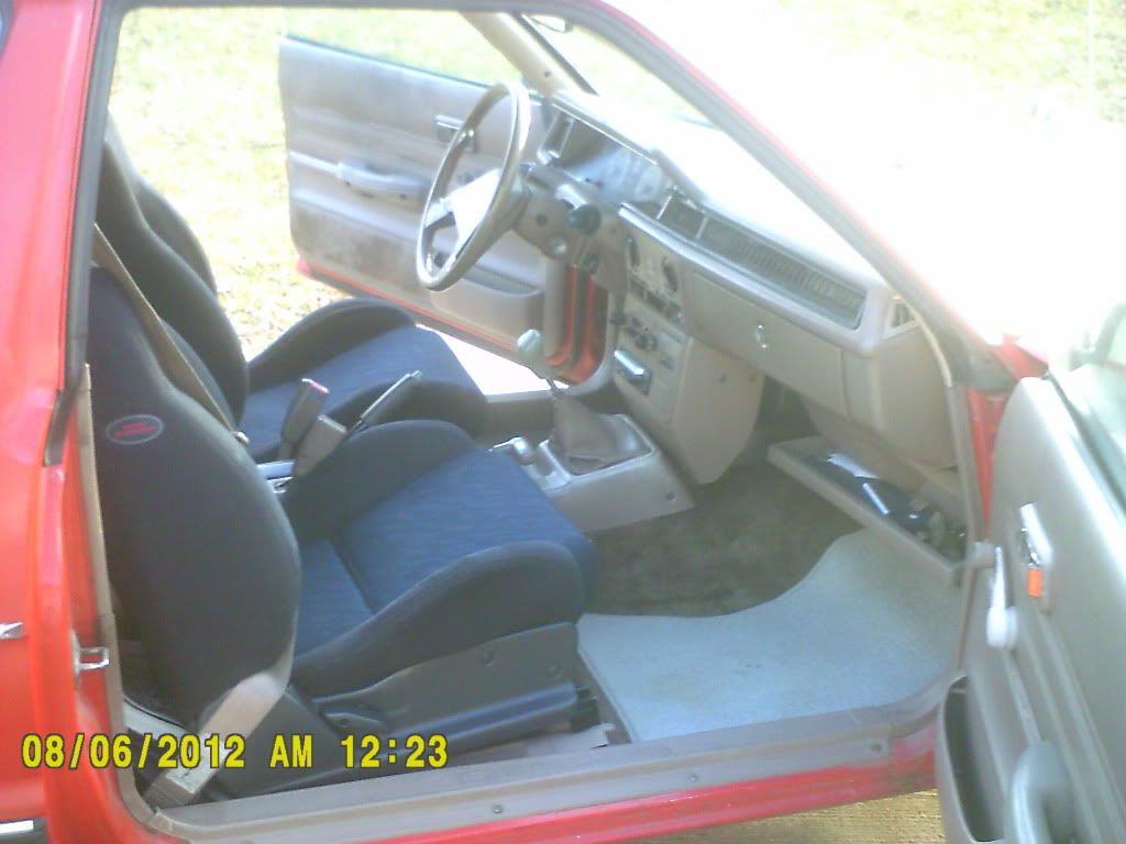

here is mine just had to slot the outer hole front.MikeyMeyagi wrote:ive made mods to the rails of the 08+ seats to bolt them into the older cars, they fit perfect afterwards and it wasnt that hard
and drill a new hole for rear inner. and make a small bracket for rear outer.
comfy
