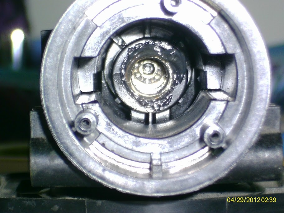

I took the actuator valve off and apart as much as I could without breaking it. The outside of it was filthy, lots of black grime. There's an electric motor in the round part of the case. I took out the center shaft and there was some grease type looking stuff on the recessed end of it, I didn't clean that off, I don't know what kind of grease to put in there. After I put it back in I spun it around quite a bit and there's some resistance in the spin, feels like there's a little sand in it.
What kind of grease or lube spray should I use. I think I have some regular front end part grease in a tube, spray can of Prolong or some uncompressed liquid wrench, it was a sample and it works wonderfully for squeaky bathroom door hinges.
Is it possible to take the cover of the valve part off without breaking it?
I think I'm going to take it apart again and link some pics. Those will come in a day or 2.

Here's the pics.
Here's the Valve assembly with support brackets removed and rubber boot pulled off.
Here's the inside of the round cylinder portion.
Here's the spinning shaft. The end at the top of the pic is the greased end. The grease looks to be a clear type but there's some grime in it. Most of the grease on it is closer to the copper wire.
Here's the bearings that I'll have to get at with Q-tips. It's a roller type bearing in there.
I still can't find a way to get the cover off of the valve portion.
I have an adjustable DC power supply that I rigged up to run it and see if it actually works. It does work, has vacuum and spins pretty good from what I can hear. I still need to put new grease in the bearings because there is a little bit of grinding that I can hear. Once I get the new grease in and put it back together my plan is to take and hook the vacuum line back up and rig up the power supply to see how the actuator is pulling the throttle.
The last time I got to use CC it was not working at 100%. I kept getting a constant feeling like it was surging or about to drop the setting just to pick it back up. The RPM's didn't seem to change while it was doing this.

Re: Cruise control questions
I don't think you'll be able to disassemble the pump part. Just try and clean it up as much as you can. A lighter grease should be fine.
One thing you could try is put it back together and stick it in the freezer for a little while to get it nice and cold. Then try it on your power supply. If it works, I'd look at the actuator in the car.

The valve is all put back together and back on the car. I tested the cable part and the first test was an easy retraction in about 3 seconds. The 6 other tries were much slower and appeared to have resistance. I would still say that all of the tests were about 3s in and out. I have already taken the cable part off and plan on seeing if I can get it open to clean it inside.

The cable part does not come apart. Looks like I hit the end of this road. I'll just have to use the hell out of CC this summer to see if it's going to work in the cold.
