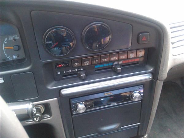

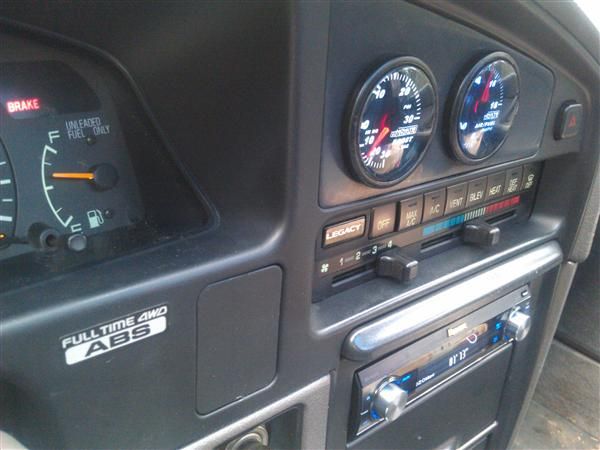

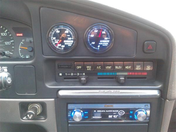

I just posted pictures of my recent center vent installation in my build journal.
Re: Boost and Wideband gauge placements
You can kind of see what BSOD2600 is talking about in this picture. I have his car now, and still use the same setup. The boost gauge lines up exactly in the center of the tach and doesn't obstruct anything when actually sitting in the car. The wideband is completely visible as well, but you can barely see it peeking out from behind the steering wheel in this picture.

Kimo, that looks good. I dont want to screw holes into my column or dash. How did you take out and fab the piece of plastic to fit? Also how do you post photos on here?
You host them on photobucket.com and they will give you codes to copy and paste for each picture and you just paste them on here and they show up.
I originally was trying to take the center vents out and fill in all the holes after removing the vent blades themselves. That almost worked out and would have been much nicer because I would be able to remove that whole piece by itself any time I needed access to the back of the gauges. But I messed it up by not prepping properly before applying the liquid plastic mix and it came apart as I was sanding it. I got sick of working on it so I traced the outline on a sheet of ABS plastic and trimmed it to fit the hole and glued it permanently into the dash bezel. Now I have to remove that whole trim panel to get to the back of the gauges but hopefully I won't have to.

Piece of abs plastic from amazon.com, traced vent panel on it, rough cut with hacksaw, cut gauge holes with drill bit around the perimeters, file smooth, stationary belt sander to trim it just right and some 3 secone hobby glue.
