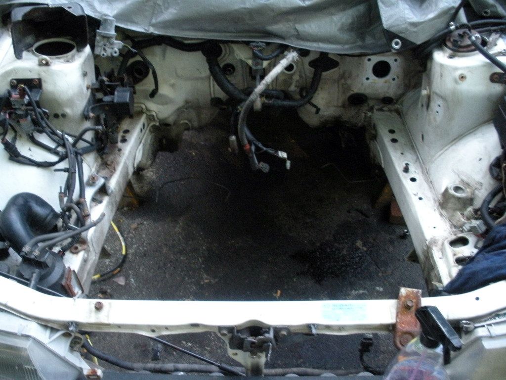

As it stand right now, entire suspension out , control arms, crossmember the works,
Pulled the motor. picture of a bare engine bay.
