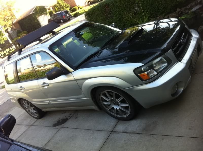

oldscoobyturbo
Posts: 506
Re: Questions 04 Sti BBS Wheels
Post by oldscoobyturbo »
I had the sti wheels on my 04 FXT they were 5x100. Unless you get the newer foz thats already got 5x114.
If your dead set on finding a set of sti rims 5x100 I can find you a set up here in Canada you would also get a choice of gold or silver too

oldscoobyturbo
Posts: 506
I had to retire that foz back in January the engine died and it was my dd. Its an all Legacy family now see my signature.
