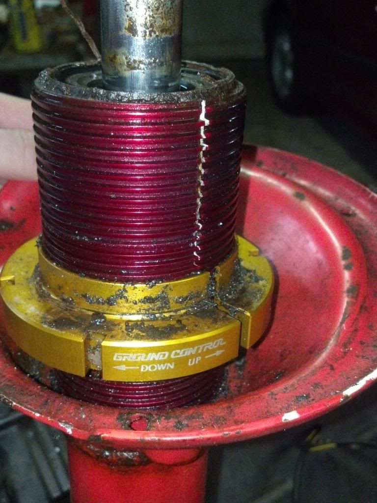

So the good news is Ground Control got back to me, and the sleeves are only $22. I did get to snap a picture. As you can see, the top piece of the strut totally came out. The mess all over is the oil coming out the top.

Looks pretty heavily corroded around the top. Does the sleeve trap water/moisture around the top of the strut housing?

Yeah, Im assuming the corrosion had something to do with it. The top piece that came off doesnt trap anything between the sleeve and the strut, however i think I made a fatal mistake grinding down the strut body to fit the sleeve around. I never reapplied any paint or primer, and that bare metal was just eaten away for the past couple years. Thats my best guess why it did what it did.
