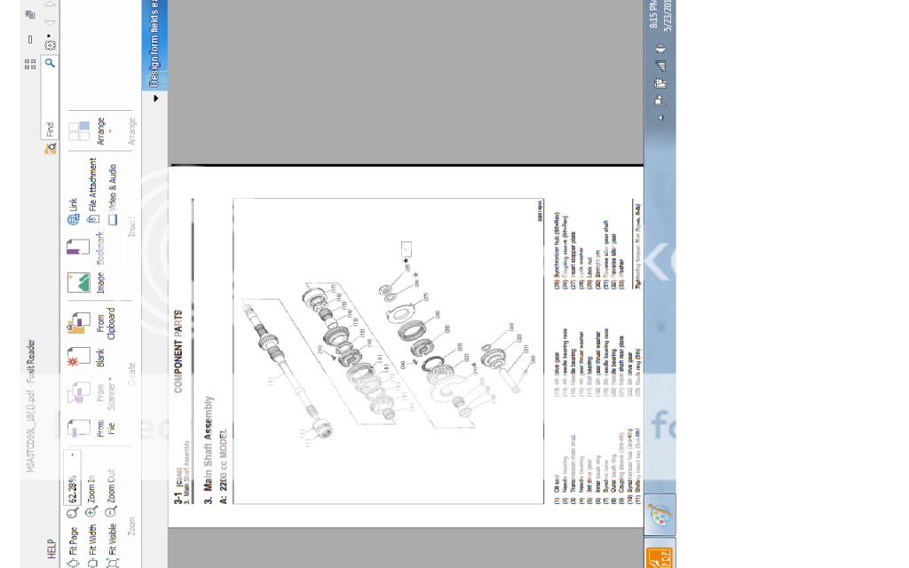

Hmmm well from my digging yet again i have found that in the 1999 legacy model year range. Probably in other also.
The main shafts in the transmissions EG: 2.5L vs 2.2L are different?
If i can find a way to show what i mean i sure will!
Its seems to me that the 2.2L main shaft has less crap on it compared to a 2.5L trans?
Does anyone else understand what i mean?

I have now figured out this trans business!
Any subaru with a 2.2L that is AWD is actually a 2wd trans with the back half of a awd trans.
So that tells me that the 2.2L trans is NOT as tough as a 2.5L trans

Well they probably are very very similar but they are by no means the same.
The main shaft on a 2.2L 5mt does not have the same number of parts on it compared to the 2.5L 5mt.
That is why im ruling 2.2L 5mt as "not" as strong as the 2.5L 5mt.
2.2L 5mt MAIN SHAFT
2.5L 5mt MAIN SHAFT
The crappy pic were pulled for the OEM manuals.
If i could just give you the OEM manual i would....But i cant soo you will have to live with sideways pics.

Tommio RS wrote:Well they probably are very very similar but they are by no means the same.
The number of parts does not really have any bearing on whether it is stronger or not. The additional parts on the 2.5 transmission in the diagram you posted are related to the reverse gear synchro, that is all.

Hmmm. You know i never though about the reverse synchro!
Dam....know i feel just a wee bit retarded....
So ya...In the end it sort of does not matter really.
If you have any 5mt and you want to do anything to it, you just need to so some research to what fits where.
