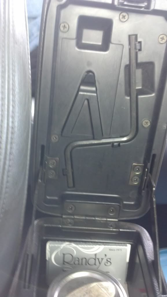

allen wrench in center console?
- Posts: 507
- Joined: Thu Oct 27, 2011 5:09 am
- Location: Dirt Roads, Colorado
I can't believe I've never noticed this before until today . What is this for? S-shaped Allen wrench stored on under side of center console door.

Sunroof manual operation. There's a plastic plug in the back of your headliner that you remove which gives access to a hole to insert the allen wrench in to hand crank your sunroof should it die on you.

I believe its also used to move non functioning seatbelts, hence its inclusion on all first gens.
Re: allen wrench in center console?
Also for the auto seat belts, the access is located on the center pilar an inch from the bottom.
