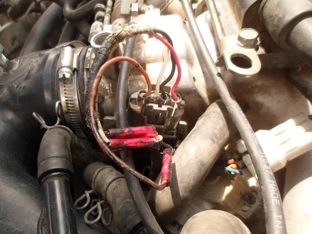

tps wiring
turbo970
Posts: 859
Location: sw colorado
tps wiring
Post by turbo970 »
so which way is right this one
or this one
the second one is based a wiring diagram below
still ildes high. the first pic is how i recieved the car back

should be like the first one. did you do the feeler gauge test?

i just switched the wires after i saw the diagram. i'll switch it back. i wonder why diagram shows it brown white black red?

ok i switched it back so its like the first pic. when i drove it while it was wired like the diagram that thing shifted better and had sum wicked pull lol. just idled high

well i drove it again this am with the wires set up in the first pic. car shifts crappy again. bust shifts better with the wires set up in the second pic

Have to double check my car. But also i think cleaning up those wires would help out a lot also.

i will i'm getting some red loom. and red tape. til i get everything set right i'm gonna keep them out like that. i know the tps is way off because it wont kick down when i hammer the throttle

Both are wrong!
Here is how they should be wired up.
http://www.main.experiencetherave.com/s ... sconnector
Just to note that my pictures are from the opposite side of the electrical connector. Also, yes if you can clean up that wiring, I'm sure that will help, but pinning them correctly should make things much better.

sweet thanks again josh. you took one look saw it was wired wrong and yet the shop couldnt lol
