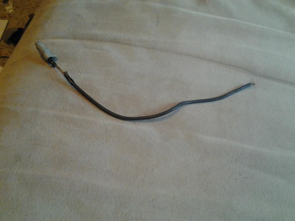

Turns out my knock sensor wire is done for. How do I replace it? It seems like its 2 wires in 1.

Re: turbo wagon help
Found the problem. Previous owner tighten a bolt over it cause it to ground and break. Now I have to replace everything.
The knock sensor wire is a shielded wire, and really needs to be a continuous wire from the ECU to the connector. You can try and find a replacement from a junkyard harness or a more realist and better option is to get some microphone cable from radio shack or similar store. It is shielded wire and you would just need to redo the connections at the ECU and connector.
What I'd suggest doing is stripping the stock wire back a few inches from the connector and splicing the microphone wire to it there. Do the same thing at the ECU. You'll need to make sure and connect the center signal wire and the shielding wire at the ECU. The shielding wire does not get connected to anything at the engine connector and should not touch the center wire or ground against the engine.

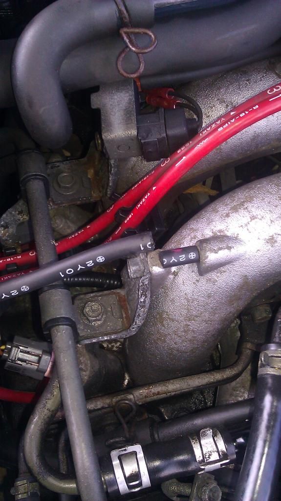

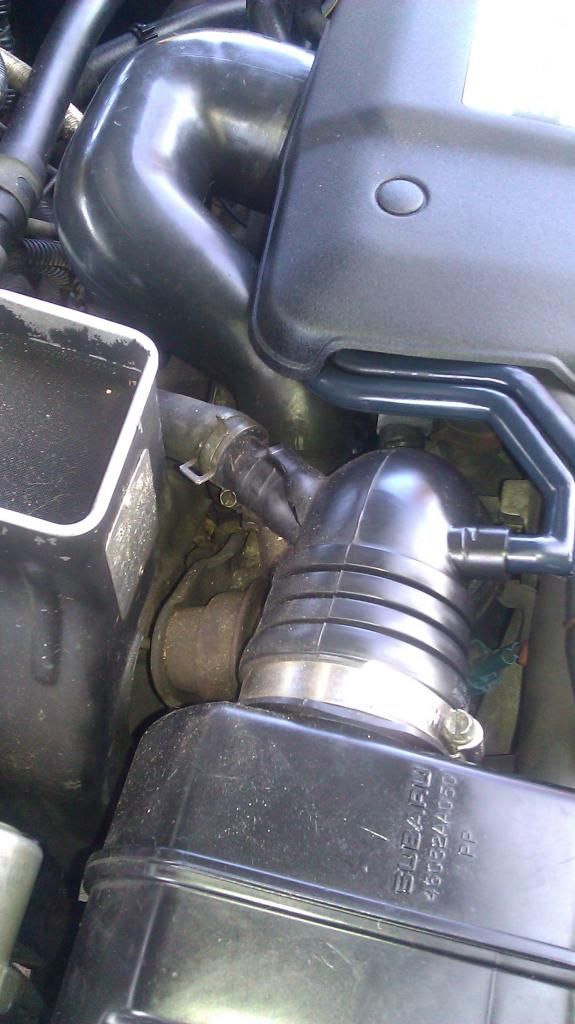

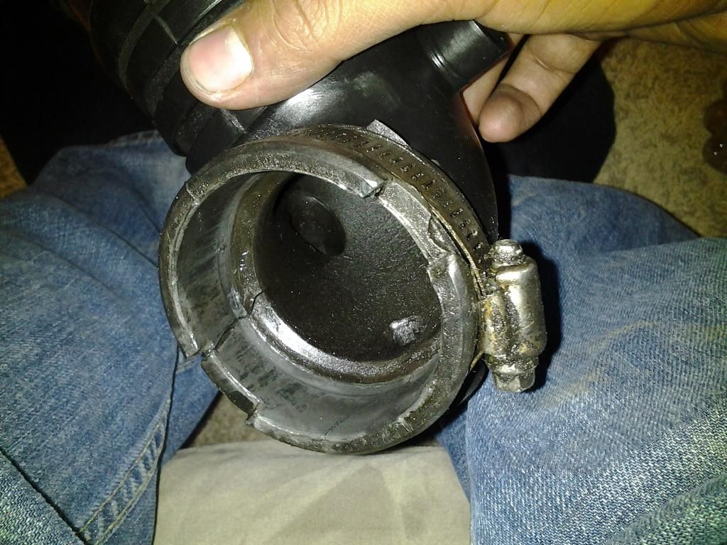

well it a good day! re-wired my knock sensor wire and no more cel! but still not getting power out of it. The turbo spools harder now and the engine pulls a little harder. Still not a lot of power. it once again gave me backfire. I drove it around and noticed it struggles to get past about 2700 rpm when i floor it. Pedal to the medal yet still very un powered. It seems like it might be vacuum leak. So i looked around and found this:
bad hose, I just moved it a little when i was looking around for the leak and it broke. I was on good when i was driving around. But when moved it a little it broke. Could this of been the leak? But the Hose wasn't broken when I drove it. Any ideas?
I also found this:
Can that crack also be a bad leak?
That is air escaping after the maf so yes that is bad . From what I heard that rubber 90 is discontinued from the dealer so search the junk yards and this forum for a decent used one
That small vac line is very important and will make your car barely drivable if craked/broken, it goes to the Pressure Exchange Solenoid and MAP sensor and if those aren't getting a right vac reading your car will fuel cut at anything above 1psi as a ECU failsafe.
The 90 degree turbo inlet is a big leak source, and YES that crack is causing a leak and making you run rich i'm sure. That line comes off the BPV return line, so it vents the air between the turbo and throttle plate back into the system once that plate closes off. Those elbows are hard to find, I would suggest a good amount of RTV seal and some gorilla tape to fix it for the mean time until you can get your hands on another elbow. Contact your local Subaru dealer to see if they can order you one from somewhere in the US, I think they're discontinued but there are a few left on order at some warehouses in the US.
So I got around taking off the elbow and turns out there's oil in the elbow and the lines going into it. Now I'm worried . Any ideas why there's oil in there?
Oil in the intake is cause by increased 'blow by' from your breathers. Both breathers from each head tie into each other at the intake elbow, an oil catch can will help reduce oil entering the intake system. It did help on my car, if you would like, I can draw up a quick diagram of how you should install it. Check your PCV valve but removing the hose and unscrewing it from the intake manifold all the way and shake it, if you don't hear the pill inside rattling around freely, your valve may be stuck and take can cause issues. If you have low compression in cylinders, like blowby is getting past rings and such, you may have increased oil in your intake tract. But on boxer motors blowby is pretty normal for the most part. Your inlet doesn't look tooo bad, just looks pretty gunky from just a dirty motor.
Yes, oil in the elbow is normal. I wouldn't worry about it too much. Get a new/used 90 degree elbow and replace that vacuum line going from the engine to the MAP sensor & pressure exchange solenoid.

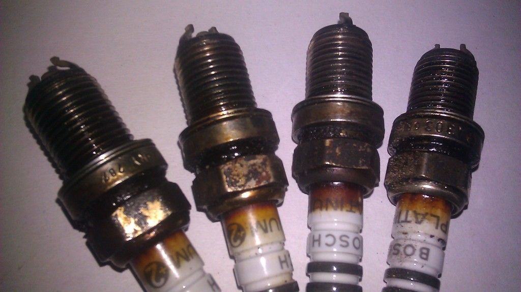

Just great! Took off my spark plugs for the first time since I got my wagon and I found oil in my spark plugs. Thats not good. What now?

Put in some new NGK copper plugs and see how she runs.

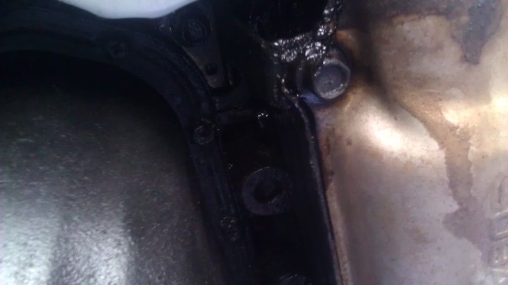

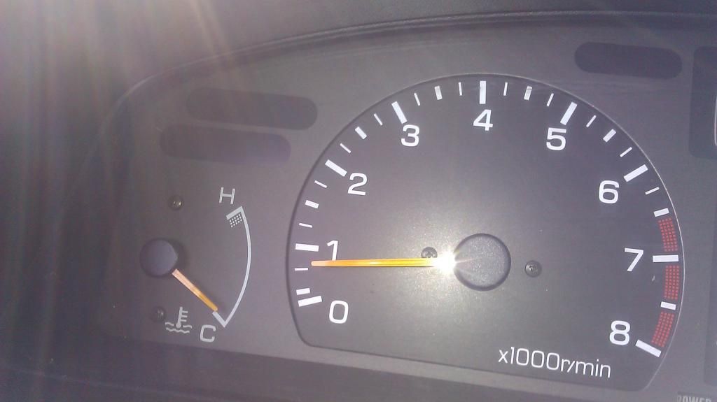

well new spark plugs are in. running a little better. I guess I'm getting all the power i can get out of it now. There's just a big oil leak by the oil pan. I guess its problem after problem for me. Here's a few starting and running videos.
note the high pitch noise at 0:53. It sounds like the turbo grinding or something.
And this is the oil leak
click on thumbnails and it'll take you to the videos
pictures of the oil leak
