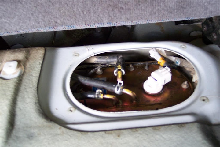

Just to clarify a little..there are the 4 Phillips screws on the access panel and another 8 - 8mm nuts to remove, plus the 3 fuel lines and electrical connector on the top of the fuel pump plate, similar to this on my Forester:
And here's the pump:
Remember! The fuel will be under pressure unless you let the car sit overnight. Search on here to relieve the pressure more quickly.
