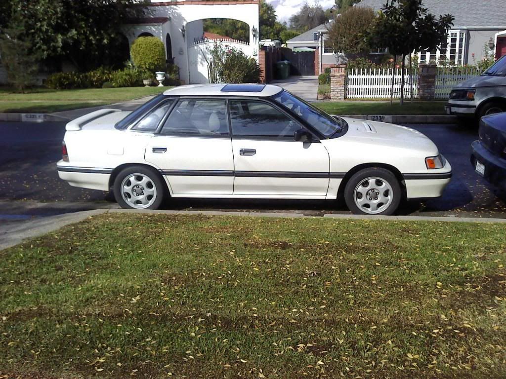

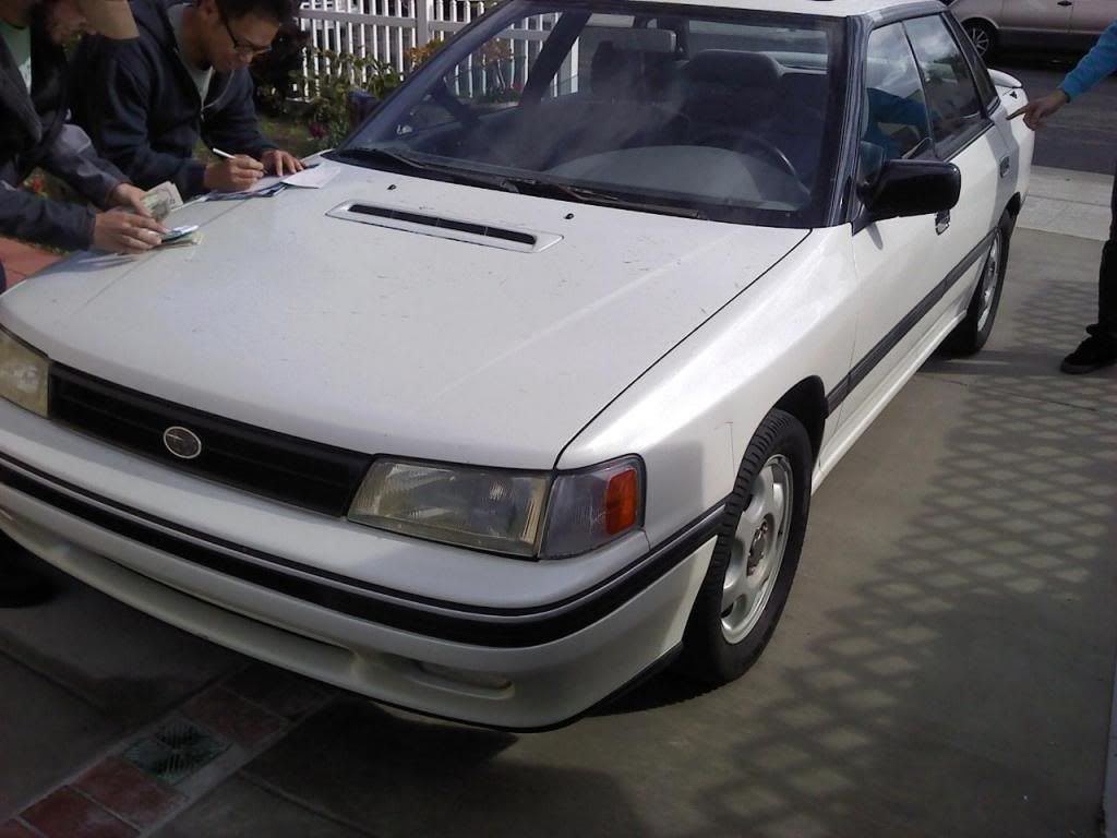

I thought it was finally time to document the build on my 91 SS. I'll start from the beginning of it all, when I had/built an 04 WRX on E85 pushing 300whp. I had taken a year off of school, worked at a towing company/shop, and loved the WRX. Then I went back to school and realized I didn't need a $10,000 car anymore. So I sold it (traded actually, long story...) Anyway, I needed a lower priced car, but had to stick with a Subaru - of course! I had my eyes on an RS, but then I found a prime 1991 SS in California. This was all happening in the fall of 2011.
Growing up in Wisconsin, California cars always seemed amazing. No Rust, nothing's better. I figured this was the one; in my price range, stock, beautifully clean, turbo'd, 140k miles. What's not to like, right? So I got 2 friends together, booked 3 one way tickets to LA, and set off to drive her 2,000 miles home, in 3 days. We took off on a Friday, and had to get back to class on Monday.
So there it is. On 11/4/11 I purchased my 1991 Legacy SS for $3,350.
Here I am counting the money on the hood:
It's mine:
And we set off, for an awesome road trip home. We pulled into my driveway on Sunday afternoon, just as planned. A few slight issues on the way, shifter actually falling off, snowstorm in Denver and the blower motor decided it had enough, cords on tires, you know - the good stuff. All in all, probably the best roadtrip I've ever had. We certainly had high spirits, coming from Cali with a clean 91 Legacy.

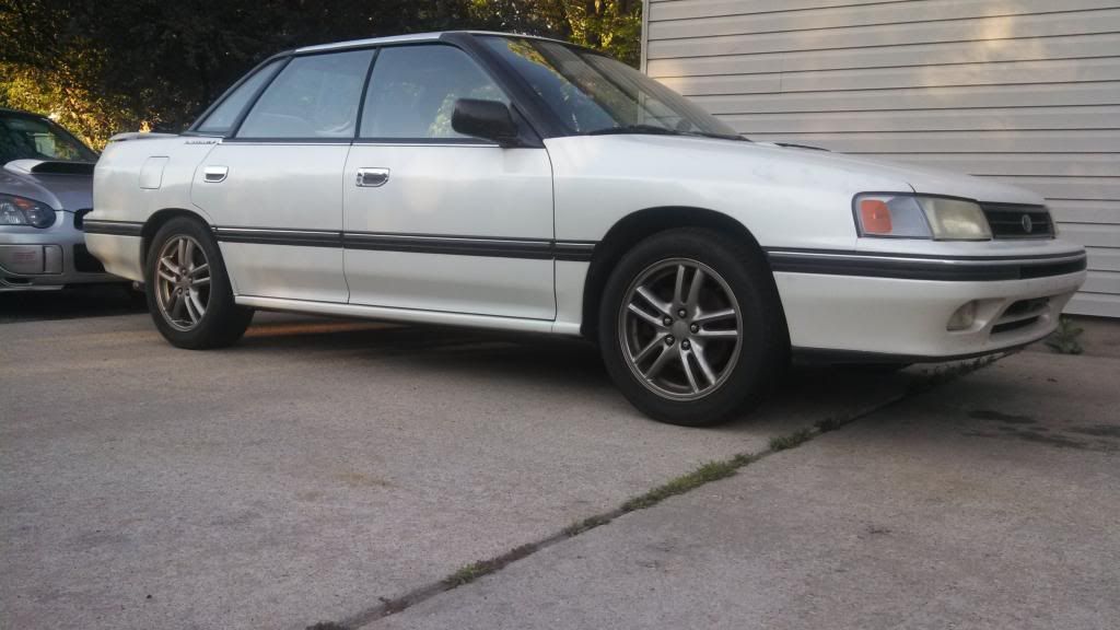

And here's my 91 prior to the swap. I had snows on the original snowflakes, and some summer tires on the wrx wheels a buddy gave me a while back. Here's how she looked most days, with no snow of course. The before pic:
Here's how she sits now, back down south as I was walking out of work the other day. I've put almost 4,000 miles on since the driveline swap, and it's been excellent to me (that's an understatement..). I haven't touched the motor yet, so it's still sitting with the Td04 Installed.

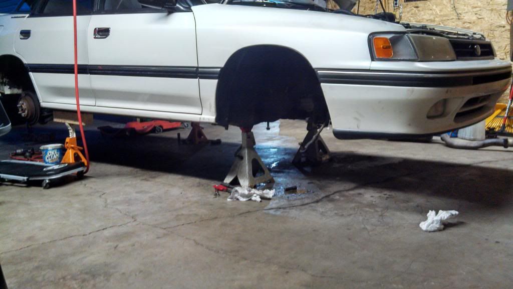

As far as the 6mt swap is concerned, it went extremely smooth. A few little issues that had to be dealt with included grinding the front aluminum lower control arm bushings down (just a few mm's on each side) to fit in the existing mounts, using my OEM Legacy tophats on the STi struts since the OEM STi tophats missed the holes by about half the bolt, finding a driveshaft that was the correct length and flanges, drilling out the starter hole and tapping the trans to accept a threaded bolt, and fitting of the STi swaybars.
The solutions to the problems were pretty simple. For the driveshaft I used the STi front half, mated with a 98 auto legacy rear half. We had to redrill the flange on one half, since the bolt holes didn't quite match. No big deal since the flanges were concentric, and had the correct diameter circle inside the flange. We ended up taking the flange off my old Legacy diff, and mounting in on the r180. Perfect fit. (Thanks Legacy777!)
The swaybars were probably the worst part. We fitted the STi front bar, using the STi mounts. The frame mounts on the 91 were to small to accept the STi bar mount, so we added an additional "ear" of metal to the mount, added a gusset to the frame and drilled a new hole for the STi mount. Basically just extended the old one. In the rear, I took mounts from a forester, and welded the STi mounts below that. It's pretty rough, but I plan to rally the 91 so I will likely just take the rear swaybar off.
Other than those few issues, everything pretty well bolted right up. Had to get a little custom on the clutch slave cylinder hoses, but ended up cutting the line just after the master and mated it up to a stainless hose all the way to the slave. Turned out pretty well I think.
On to the pictures.

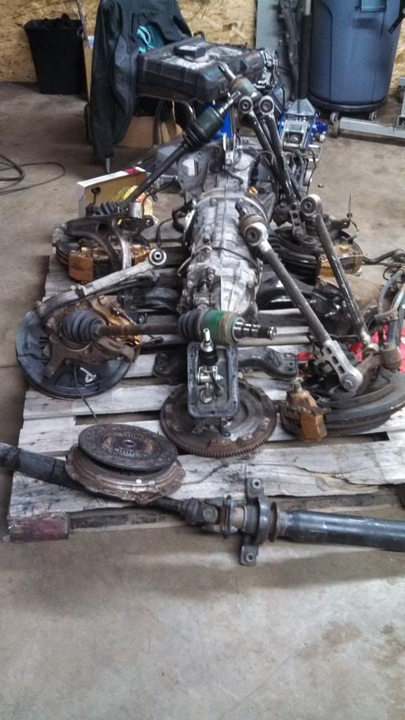

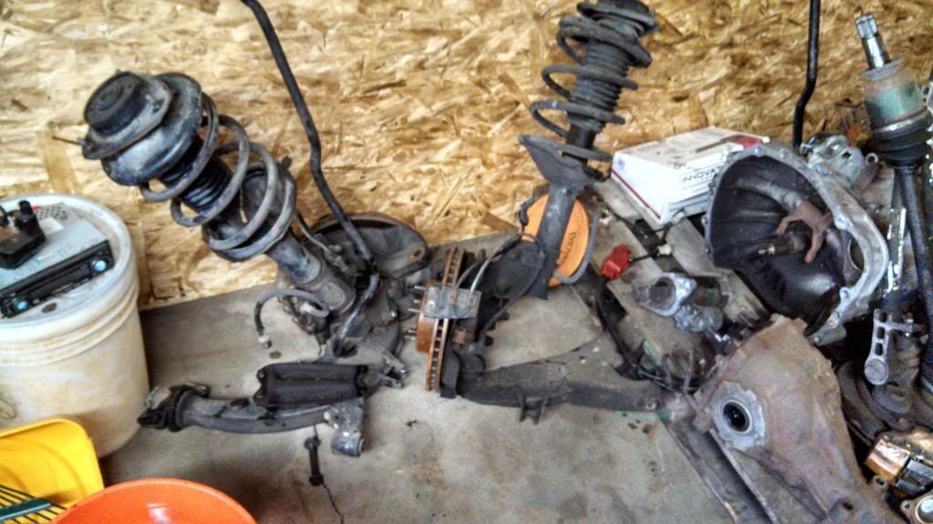

This was about 4 hours in. Unbolted the control arms, unbolted the tophat and the whole assemblies fell out. California car, no rust = awesome!
Pile of old parts:

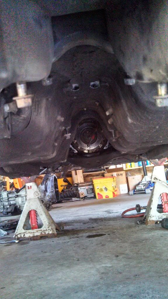

End of day 1, she's nekkid!
Empty Rear:

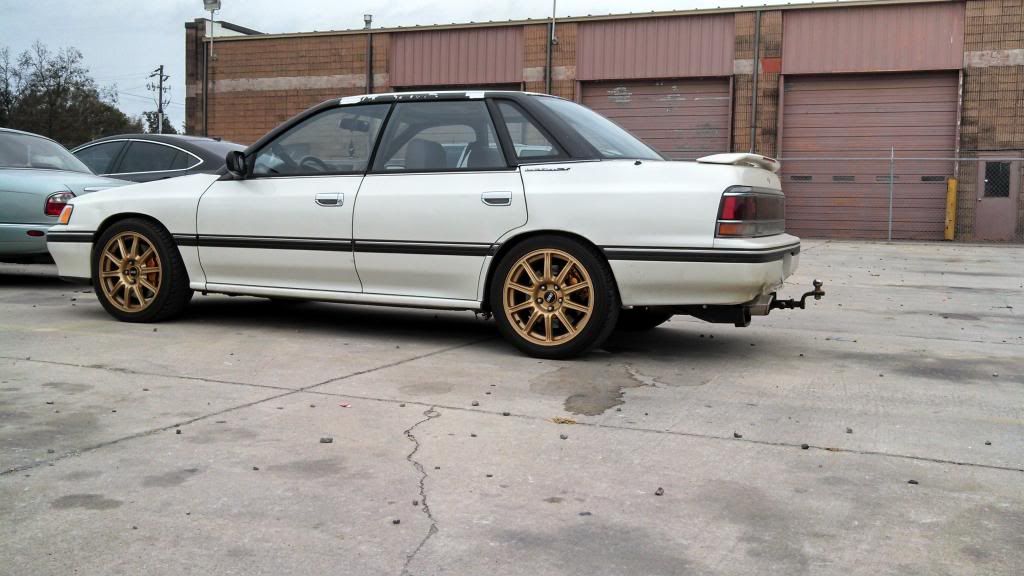

I'll leave you with the first picture with the new shoes on:
I know the headlights are ugly...I've got a set of EDM lights, but they ended up damaged in shipping :( Luckily they were insured, so I got all the cash back. And I got to keep the lights. They're almost done getting rigged up, I'll snap some pics once they're ready to be installed!
