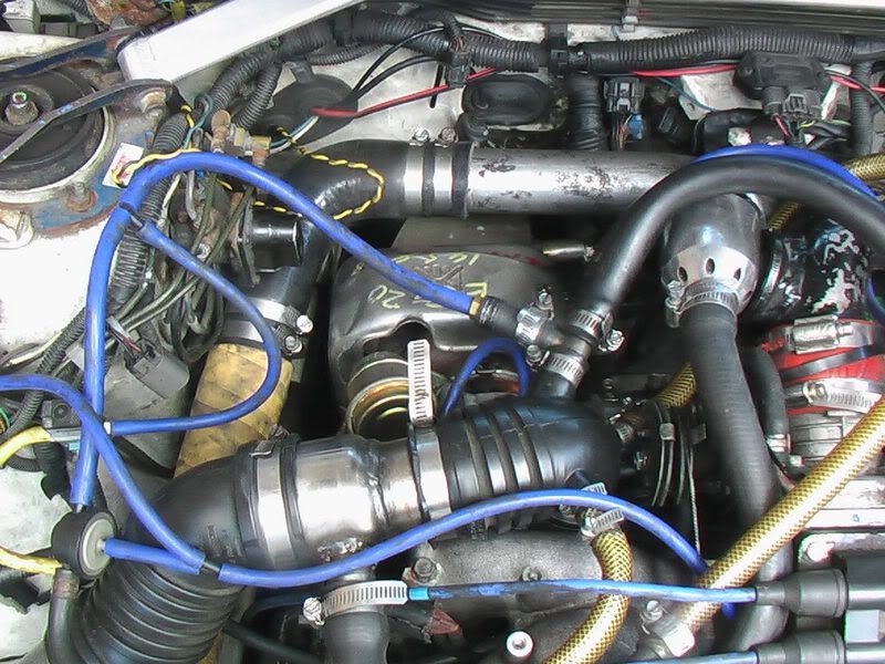

i got the same kit, but i never put it in. why becuse subaru makes a nice one factory, its a stock shield that covers the turbo. also in the summer time i use the legacytrubo stacker one.

Image its stock on must new turbo subarus, i got this one from a jdm but i seen them on northamerican cars.
i just put this on last night for winter.[/img]

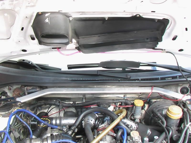

then when i use the legacy turbo one i have the hole in the hood for summer jdm aluminum hood from japan.

the pipe never gets hot at all with the covers on, you can see the stock turbo cover and the aps down pipe cover that comes with the exhuste kit. + the hood blows cold air all over that pipe so it never gets hot at all.
