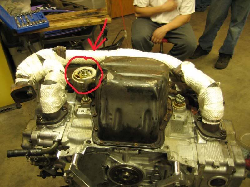

really there is an oil coolant cooler??? i tryed searching and didnt turn up much? dose anyone have any more info on this? very interesting hmmm. so whats the deal with it do they go bad sometimes or something?
douglas vincent
Posts: 3336
Location: OR, Portland
Post by douglas vincent »
WHere are you?
Its between your oil filter and the block. There's water hoses coming in/out of it. You don't *have* to use it, as the 92-94 SS's didn't have it.
awdwagon
Posts: 90
Joined: Sun Oct 01, 2006 11:06 pm
Post by awdwagon »
ok, well im looking at the pic here, and its a bit confusing is it the lines that go into the side of the oil filter asemby or is it that hose that it just before the oil filter asemby can u get me a better pic or explane it a bit better thank you for all your help you guys. also what do you mean by i dont have to use it??? can u just block it off or something lol.
