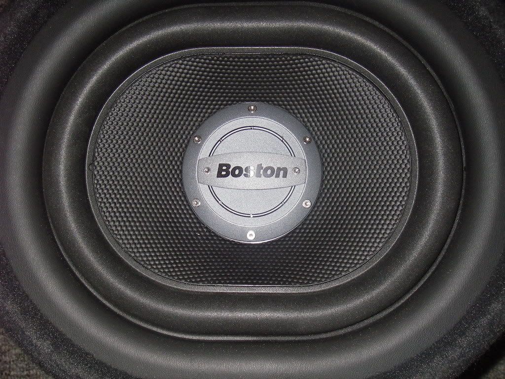

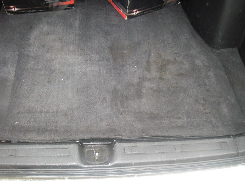

Legacy777 wrote:What do you have in the car to already have a little light dimming?
Too small of wiring will usually cause that IMO. Also, installing a capacity will help. With a properly setup system, you shouldn't really have any issues.

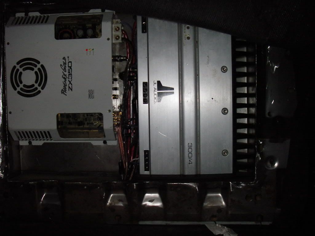

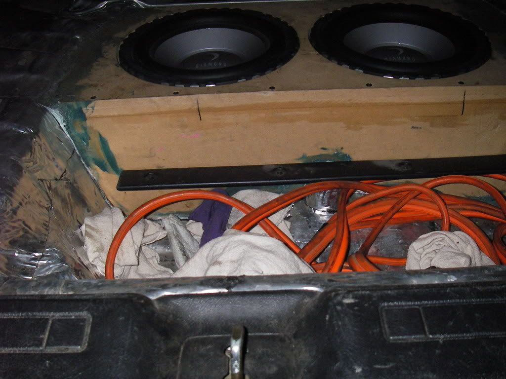

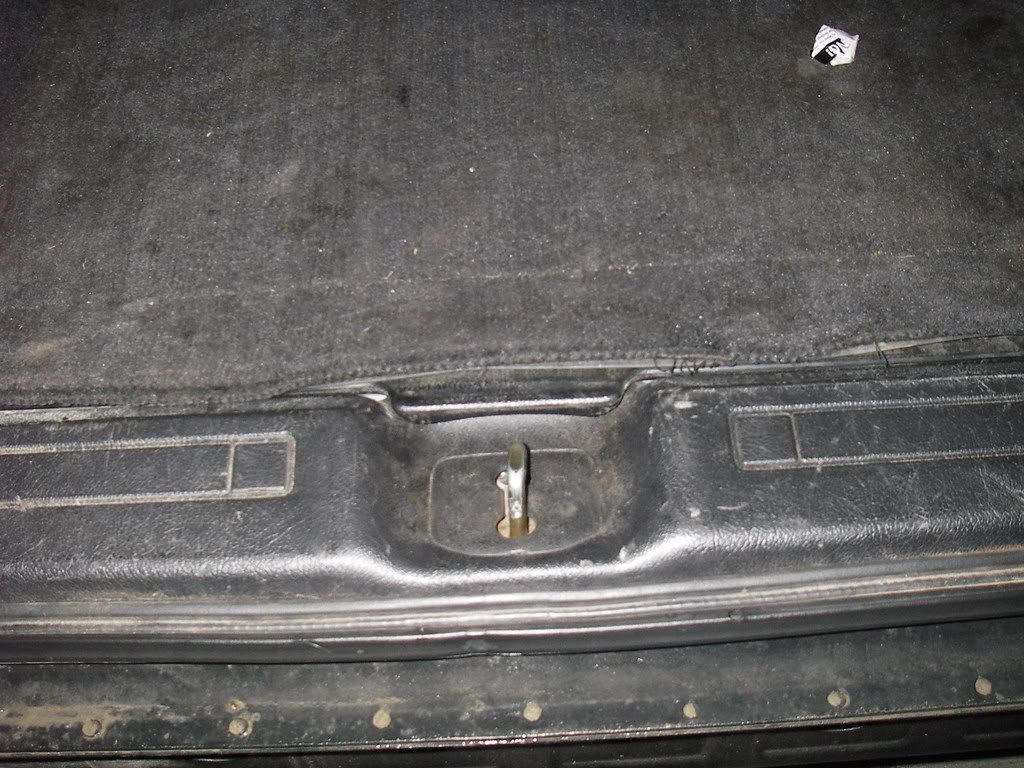

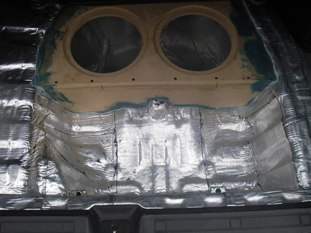

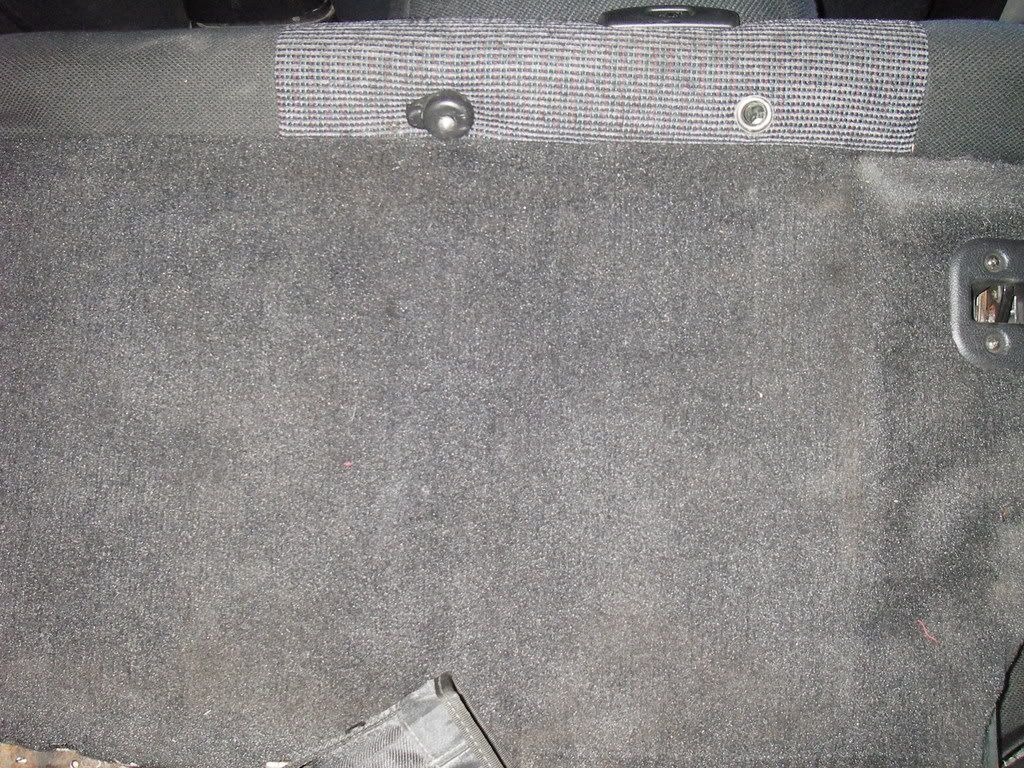

you want to see?? its not quite done.. ill show you but dont tell anyone... :-D
(backseat)
(tire compartment)
it beats! and it only dims a little when im running everything.. (lights,heat,tunes,wipers,ect.)the smaller wires are only like 2 feet long and the power wire is awat gauge..(its the biggest wire..how to spell?)it was installed by a pro who happens to be a great friend.. im not sure how long he has been doing car audio installation but its been a long time... he went from car toys to best buy to magnolia and now he is at a place in bellvue called benchmark.. its the top of the line he shows me pictures of lambos all the time.. he put a laser shifter in ichiro suzukis new porsche! :-D

The power wire you are using is refered to as 1/0 AWG. That is what I have sitting in my garage on a spool waiting to be installed. I'll be running a relocated Optima in the trunk. The fact that I have a dealer account with Metra Electronics is a plus with purchasing all my goodies (Metra, Tsunami, Raptor, Axxess, Monkey Video, etc.). :twisted:
BTW, the trunk install looks like it's at a good starting point. The JL Slash Series amplifiers are great to use. I'd love to get my hands on a 500/5 sometime!

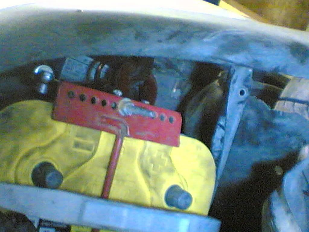

dropdfocus wrote:I'll be running a relocated Optima in the trunk.
heres mine... :-D see the isolator? that too is not quite finished.. im hoping to route tubing around that when i do my fmic. :D
