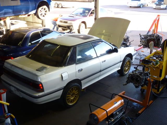

Spent 3 hours working on my engine tonight. I got my tbolt clamps in the mail today. Now I have like 20 of them at least. Various sizes.
Bought some fuel line not knowing what size it needed to be and it turned out to be too small. I tore the hose on the passenger side fuel rail a while back. I was working on my car tonight starting at around 3am so no stores were open to get a larger fuel hose. Then I found a fuel hose off the fuel pump/sending unit that came with my swap and it was the perfect size. Trimmed it down a bit and it fit right on.
Then I put my new hose clamps on the intake and wrestled with the turbo for about half an hour trying to get the stupid silicone hose on it.
I will NEVER use an intake that goes under the manifold again!!! It's so much of a hassle. Don't do it. It's miserable. It fits tighter than a nun's cunt. Too tight (never seen that before have you).
Intake is bolted back down again for good hopefully this time. Installed the Group N picth mount except I'm missing the bolt that holds it to the firewall.
Installed these nifty little insulators that hold the tank onto the manifold without transfering heat to it.
I also need a power steering pulley. I'm missing mine somehow.
Does this break booster hose go on the intake here?
What is this connector for?
Finally a quick mockup with the intake, maf and intercooler in place.
