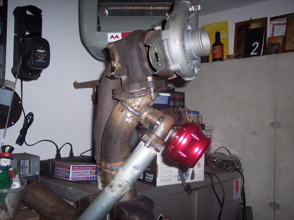

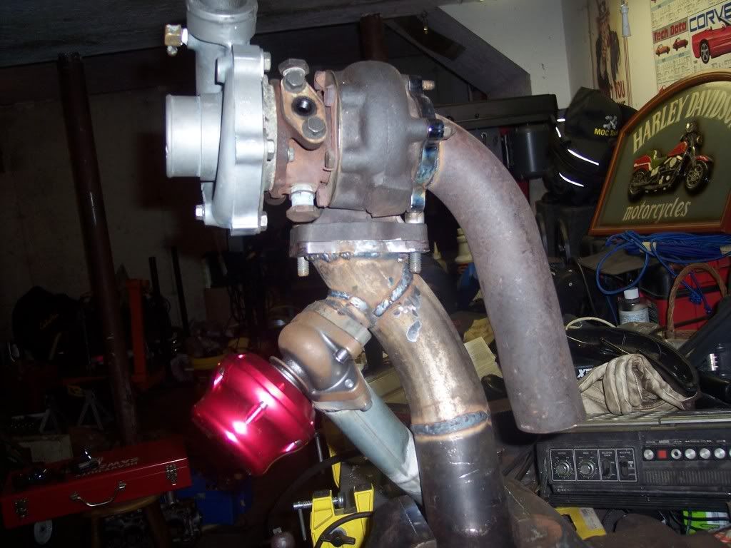

heres some pics of my turbo piping i just fabd up today. wastegate is some ebay one. read good reviews on it so hopefully it opens. ive done all of this for under $500 =], just need a way to intercool it. any ideas?
What diameter up pipe is that? Looks pretty big. I think you want to keep that at stock diameter for optimal velocity and spool up.
I think the stock inside diameter of the up pipe is like 1" maybe 1.5". I don't know how much of a difference there will be.
haha it wasnt made to be a performance machine. i just didnt have any smaller piping laying around. im just doing this cuz for fun. details are...

ebay wastegate set at 4 psi
turbo is a tb0363 from and older volvo. comparable to a vf11

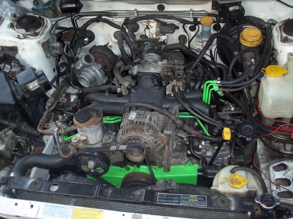

That's crazy, your fuel lines stick up super far above the manifold. I dunno if they're like that stock on the EJ22T but on my EJ20G they're the same level as the manifold.
aha idk why they do that actualy. those are the lines that came with that manifold. also i tried to start it up today but the ecu isnt turning on. idk if i have the wrong ecu or if is dead. is there any real way to tell what year the ecu is from?
