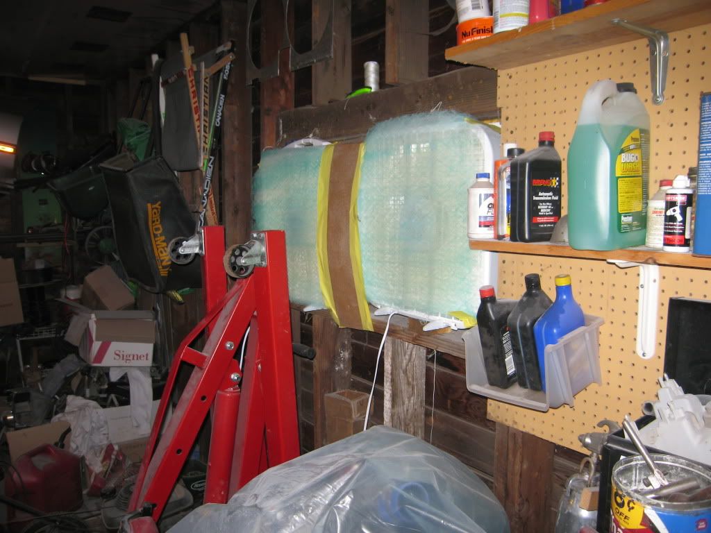

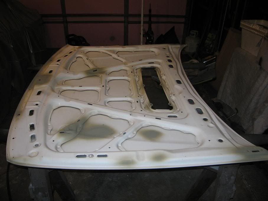

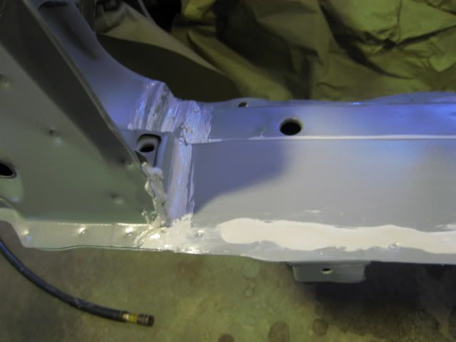

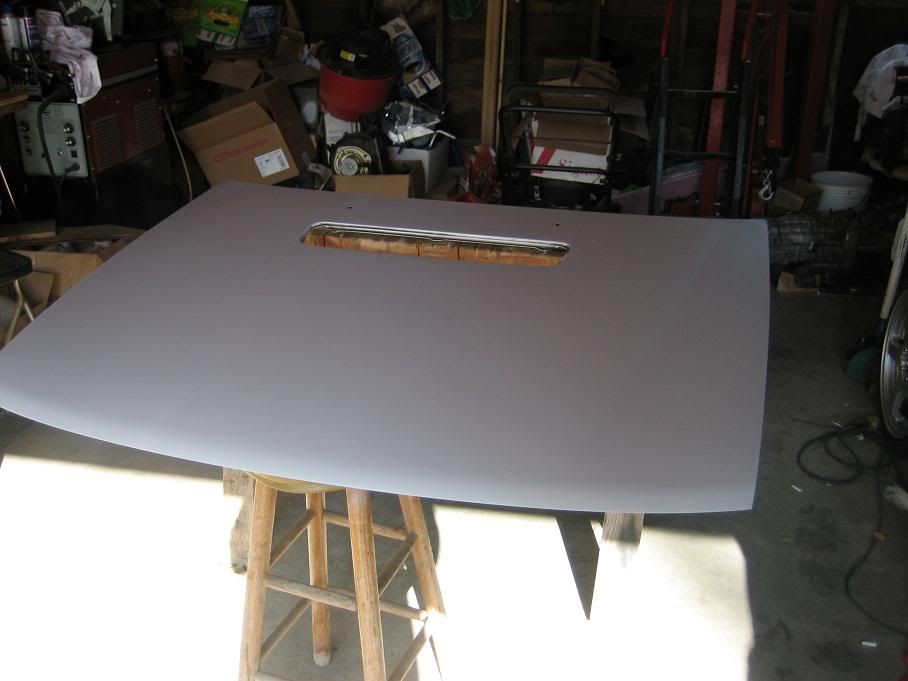

Sanded the hood down to bare metal and hit it with three heavy coats of polyester primer/surfacer. It will get sanded down a ton, namley to take care of the light hail and outies the hood has. That material is essentially a sprayable body filler, which is really nice for light dings.

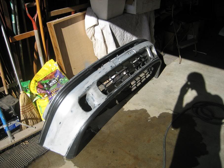

I have about 8 hours into sanding the Rustoleum off of this bumper cover. I'm really regretting spraying it with that crap last summer. I'll never use it again.

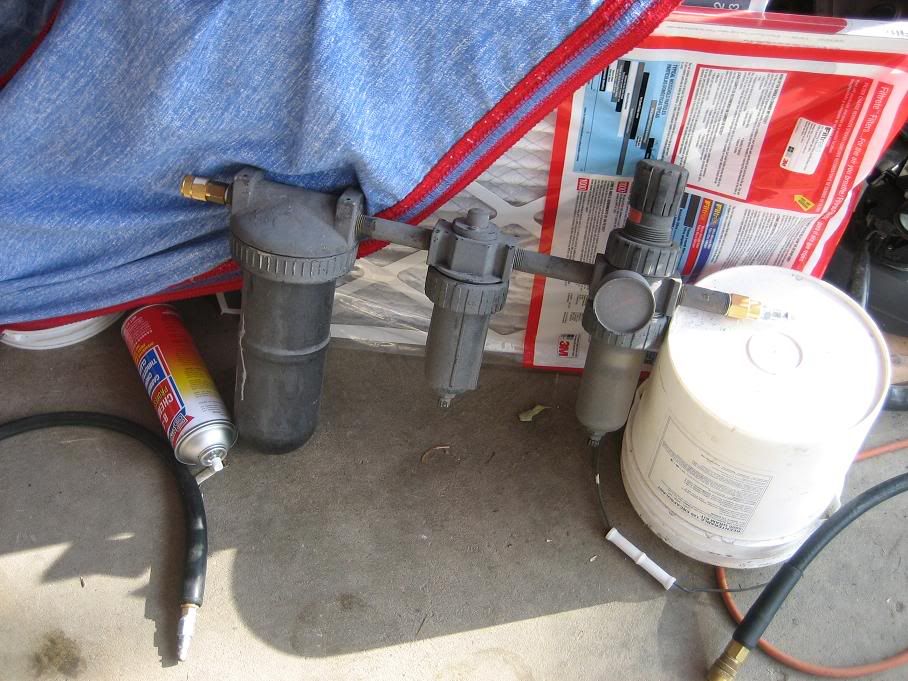

The filter/dryer setup I'm borrowing. I had to put new desiccant in it, but thank goodness the two filter elements were in good shape. When I asked the guys at Northern Tool if they had any silica gel desiccant, they looked at me like a pig staring at a wristwatch. :roll:

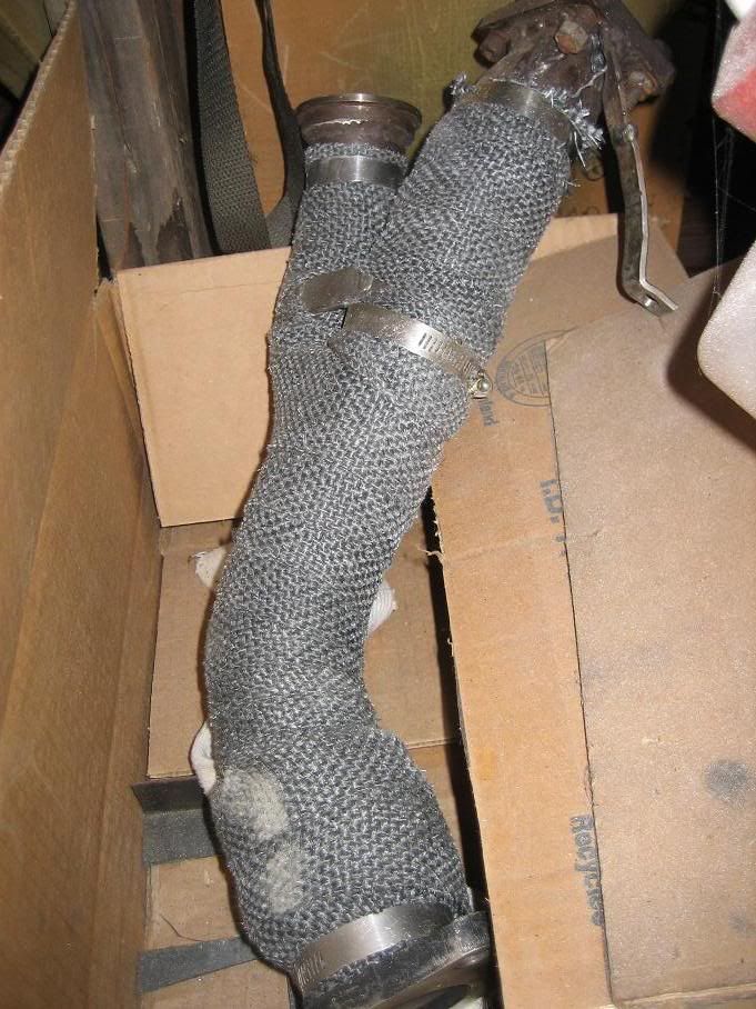

Lastly, I wrapped my uppipe, mostly to keep my power steering lines from melting. I'd rather do some Jet Hot, but the PPG man has got me down these days. I might end up cutting it apart this winter anyways...

how did you get that heat shielding wrap to look so damn good?
I tried it on my turbo and it def does not look like that.

As far as the wrap goes, soaking it in water for a half hour is key. Much more workable, and it keeps the dust down. I always wear a mask anyways. Planning out how you go about it helps too. As you can see by the amount of clamps I have, there are two pieces.

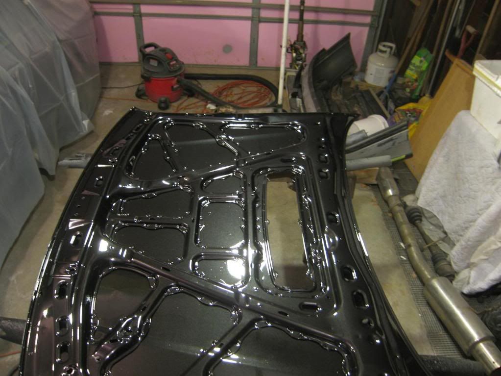

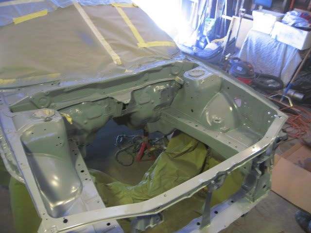

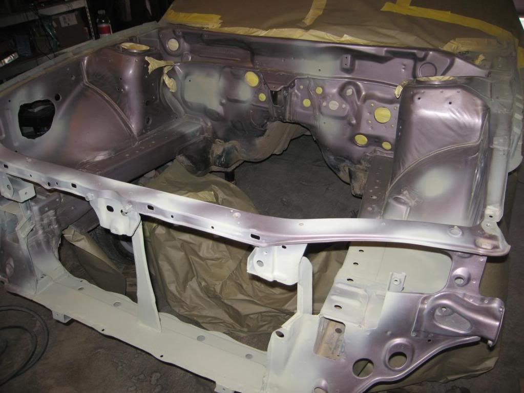

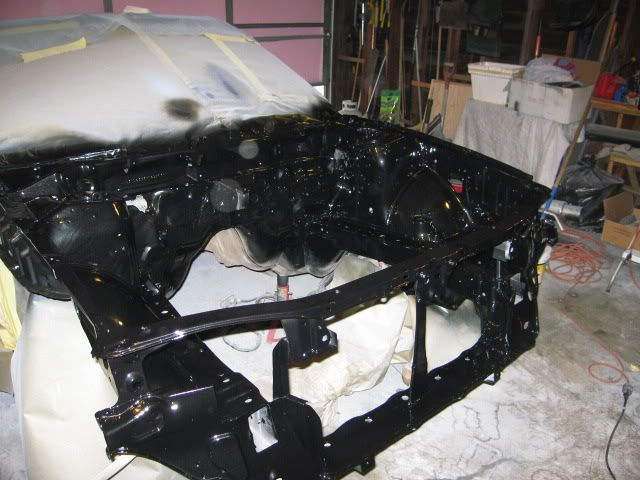

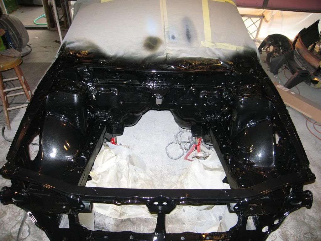

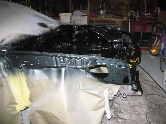

We sprayed the bottom of the hood and the engine bay. They turned out pretty decent. Dirt is a constant battle when you can't clean every nook and cranny of the frame rails and what not.
Anyways, the Chrysler PXR looks sharp and I wish this camera would do it justice.
Huge thanks to Marc Tuttle for taking a day off of work to come and spray. This wouldn't turn out nearly as nice without him.

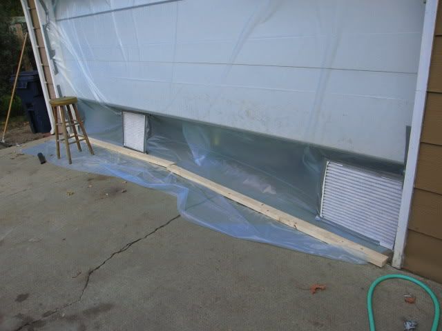

I kind of paintbooth-etized the garage. Two 20" box fans in one window with over-spray arrestor media over them. The main door got covered with poly, and I used two furnace filters for the incoming air. Bugs are really annoying.
All bare metal was hit with a catalyzed acid primer, then sealed, and finally base and clear. Also, 3M urethane seam sealer was used in key areas.

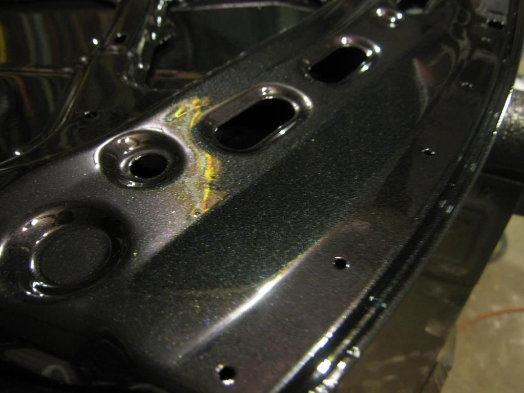

One gripe is that the american shells aren't stamped as nicely as the Japanese shells. Notice the ripply strut towers. The wheel arch on the drivers side, along with areas on the firewall get a bit wavy. Not a big deal since the price was right, but being a geek I notice these little subleties.
