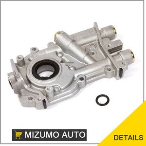

Post by ugaucin »

Re: turbo wagon help
Thats an oil pump. The bigger black ring is the front main/crank seal.

Post by ugaucin »
So I shouldn't get it? I thought it was the seal and oil pump. I thought it was the same thing.

Post by rallyak »
You can buy just the seal and o-ring, I'm about to do that with my wife's car.

rallyak wrote:You can buy just the seal and o-ring, I'm about to do that with my wife's car.
Wont it be easier to replace the whole thing?

Post by robertpaige »
Removing those seals is a pain in the ass but not that bad, it would probably just be easier to replace the pump which isn't a bad idea if you don't know the last time it was changed but if it's not old then theres no need to do the pump. Cam seals are right behind the main cam pulleys, you can take them off with an air gun and it will expose the seal. If you do them, make sure you put them in evenly and make sure they are flush with the surface. Meaning they don't stick out or go too far in.

Post by rallyak »
Those seals are easy to replace and cost way less than the whole pump. You just remove the pump and on the back side there are five Phillips screws to remove. Then you take the pump apart and just knock out the seal with a socket, then clean the pump up and reassemble put some oil in the pump and good as new.
I've torn down thousands of engines and I can say I've only seen one pump failure. The oil pump is the first to get oil and almost all of them had no visible wear and all were in spec.
The seals from Subaru are less than 15$ and all my cars have the original pump and one of my cars has over 700,000 miles on it.

Yeah, the pumps don't typically fail. The screws on the backing plate can sometimes loosen over a long time, but I wouldn't say it's common.
While replacing the seals & oil pump isn't too difficult a job, you should have some mechanicing knowledge or this could be over your head. The other thing to note is that there is an o-ring between the oil pump & block. If you're replacing the seal, it's a good idea to replace this as well.
