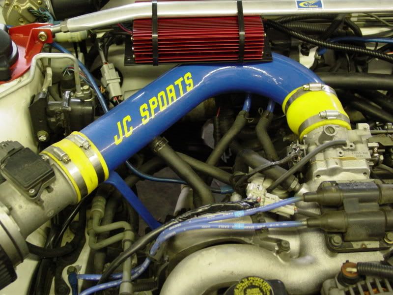

Ok guys, my MSD dis-2 is in!
First of all so I didn't have to cut factory wires I got another coil pack plug harness off another old Legacy. Wiring was straightforward following the manual.
Unfortunately, I had ta mount it by hanging it underneath the Front upper strut tower brace w/ big ol' zip ties yikes I hope it holds
anyway for my BF I set switch dial #1 to position 1
since I didn't even hook-up the pink wire, no need to set the Step Retard dials. Same with the Blue wire which I didn't hook-up either so I didn't need to set the RPM 2 step dials either.
On the way home from work it 'stumbled' @ about 4,800RPM so when I got home I reset the RPM Max Rev LIM to 6,900 RPM and now everything is GREAT!!!

Here is my installation :D
location was limited by the ABS
no room on the firewall either
Continues to work Great!
1991 Subaru Legacy BJ 2.2L/2.5LSTi Block Hybrid N/A w/ over 250,000 miles! 1992 Yamaha Seca II 2004 Dyna Super Glide My other car is a Go Kart Redhair...Black Leather...My favourite colour schemes. If it's not Scottish...it's Crap!
Posts: 27934
Pretty ingenious mounting spot :)
