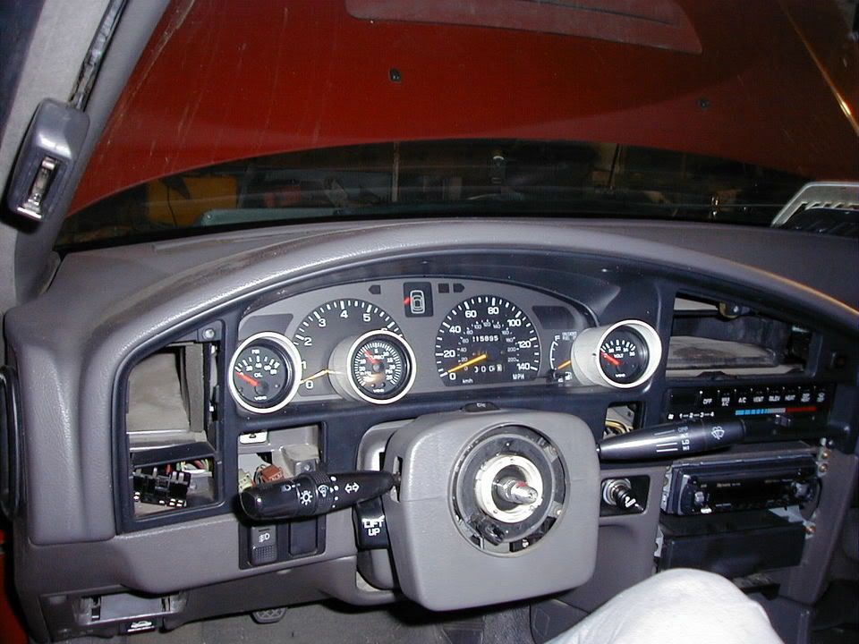

Center of the tach is a very good location, easy to see, blocks nothing. I have seen other mount a boost gauge off the column so it sits in the same line of sight. Put it in a clean little pod or mount and it should look ok (and a LOT less work ).

so far, my ideas for a custom mount would either be in the vent to the left of the steering wheel, or in the cluster in front of the RPM gauge like All_talk has his. Any other ideas or some pictures of how others have mounted theirs?

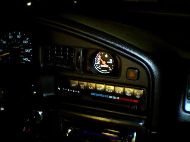

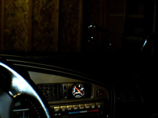

I mounted my gauge in the right center vent. This allows me to keep the left one which holds the up/down adjustment for the airflow. It is off the side a tad but still easy to see. I also put it in the right side as opposed to the left because as I turn the wheel, my hand would cover it up if it's in the left vent.
skid542 wrote:I mounted my gauge in the right center vent. This allows me to keep the left one which holds the up/down adjustment for the airflow. It is off the side a tad but still easy to see. I also put it in the right side as opposed to the left because as I turn the wheel, my hand would cover it up if it's in the left vent.

It is definately not as easy to see as a pillar gauge or the ones mounted in the gauge cluster. But it is pretty nice and provides a good clear view with a quick glance. You can also just make a false facing to stick on with some magnets if you really wanted to keep it sleeper. You will have to trim the vent ducting a little but running wires to the ashtray is super easy .
I have mine mounted in the center of my tach. It doesn't block anything there, and I can check it at a glance along with my other gauges. But then, I'm not a big fan of pillar gauges.
skid- I like your setup. Have you considered a gauge angle mounting ring? What did you use to fill the hole?
Beatersubi - Thank you, I'm pretty happy with it. I have thought about angling it but it's still very readable and I just didn't feel like messing with it. The back is just a piece of balsa wood that I cut to shape to use the screw hold downs of the vent. I then rienforced the back with some carbon fiber. Little spray paint later and viola! The big thing is I want to keep my car very stock looking from the outside and I can make a fake front very easily.
