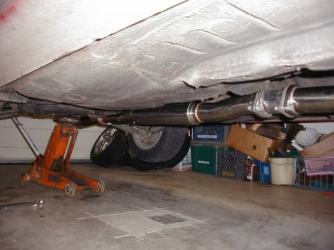

Yep, typically a resonator is near the mid point of the exhaust length, having an expansion point there helps absorb and reflect the frequencies with shorter wave lengths (higher tones). There can be a lot of science in the sound of an exhaust. I’ve heard Ferrari actually tunes their exhausts to specific notes.
My 3” Helix turbo back has a center resonator and a huge straight through can, its quite loud, but sounds amazing. Even in the winter I usually drive with a window partway down so I can hear it better.
:-D I'm going on 40 and most of my co-workers tell me my car sounds like something a 16 year old should drive... I dont care, I love it.
Pics from install day
Gary
