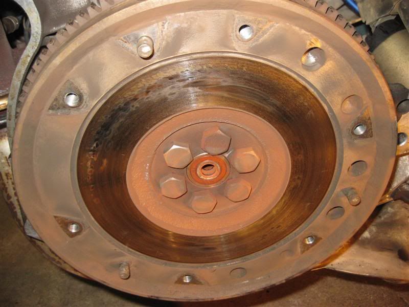

The only thing I can think of is maybe the flywheel I installed is different. Maybe the teeth aren't in the same place, exaclty? Please don't tell me I have to take the tranny out again. That wasn't fun.
The flywheel was from Autozone and it was a Luk flywheel.
http://www.lukclutch.com/catalog/detail ... ement=1.0L
Here's the pictures I took of the flywheel before it went in.
