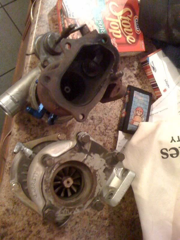

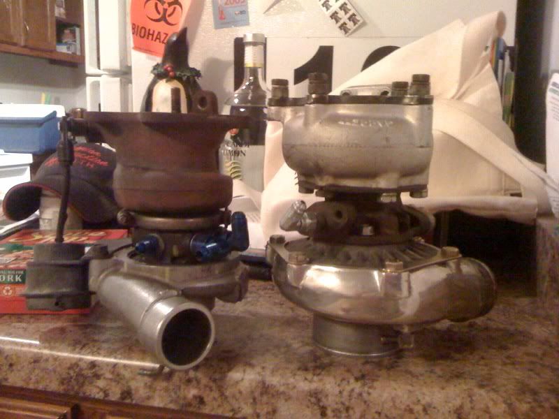

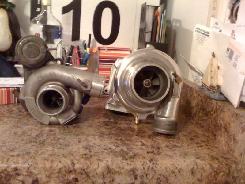

Where's the pics of the hot side? If it's a .48, that is awfully small. If it is a standard frame turbo you could find a larger housing, which would pair nicely with decently flowing heads.

good thing I'm not trying to make 520HP then haha. I'm getting this turbo for basically the price of a used TD04, so I'm gonna run it for atleast a while. I'm sure it flows well enough to over come what my tranny can think about holding...
