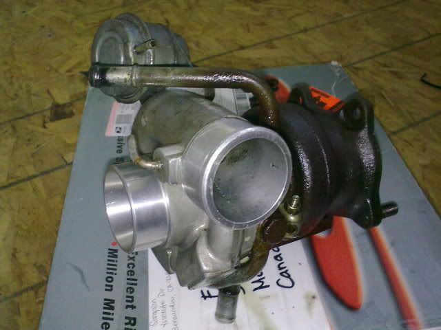

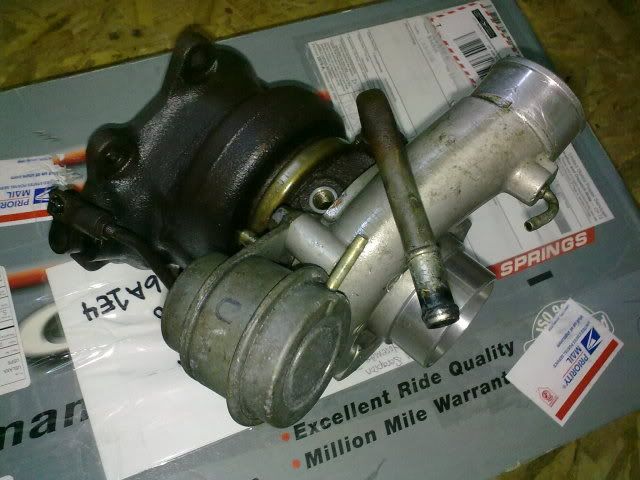

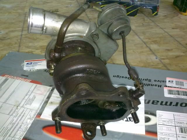

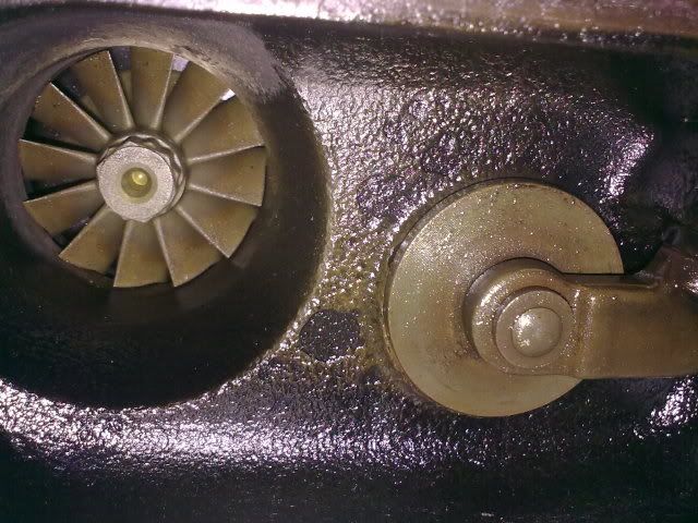

I read some up and down play is fine, but this one gets pretty close to the housing actually might be hitting the housing. Has 120k km and I paid $145 CDN locally shipped. He told me no shaft play..... My dads theory is when it gets really hot the thing should have no shaft play at all because there is some expansion.

Great. My friends tell me they have never touched a turbo that didn't have up and down shaft play. Doing some reading and it seems like it is almost impossible to get a TD series turbo with 0 shaft play at all unless it is reallly really low mileage like yours.
So up and down is ok but not in and out?
slight shaftplay is no issue at all.
i turboed my old 2.0l mk3 jetta with a brand new gm-1; the turbo had absolutely NO miles on it but it had as much play as my 40k tdo4.
side to side is really nothing unless its hitting the housing. remember, the shaft spins in a cushion of oil and not taking any unsual deflection.
in and out play is bad.
