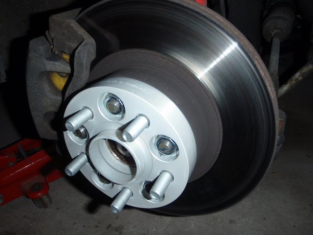

I have hubcentric 25mm wheel spacers
Mine are built by Eibach and they are a different design. Mine don't require longer studs. The spacer goes onto the hub and is bolted down with the included low profile lugnuts. The spacer itself then has lug bolts that your wheel is mounted on and you use your original lugnuts to secure the wheel.
Sorry yazmo, I don't have a picture at the moment to help explain.
One thing to be SURE of is you need to find out exactly what kind of aluminum is used. It is not enough that they say 'it is very strong'. They will always say that, and I doubt they have a warranty that will cover your car and your health if something happens.

they are hubcentric
they came with the studs pressed in
they came with nuts that go on the hub studs
so you use your lugnuts to go on the spacer studs

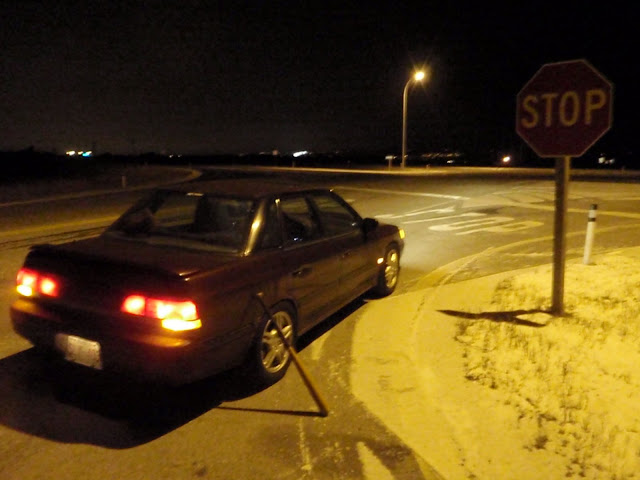

Posts: 27930
Why do you have a baseball bat leaning against the car.......
asc_up
Posts: 2473
Post by asc_up »
I was just about to ask that as well. Hooligans...
I was wondering the same thing. A legacy...snow...intersection....basebal bat? WTF!

You can roll fenders with a baseball bat?
asc_up
Posts: 2473
Post by asc_up »
Yup, that's how I did mine.
