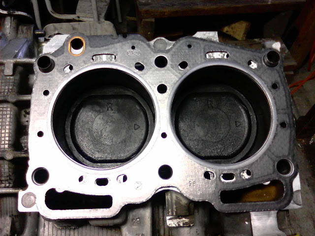

Pay attention to the coolant passages besides/around the cylinder walls.
1991 EJ22T gasket:
1991 EJ22E gasket:
These graphics are of Felpro gaskets, and would also fit other years as well. I'm sure someone smarter than me can say "oh those fit, don't worry about the passages" since I'm not an expert.

wtdash
Posts: 2351
Location: N. ID
Re: ej22 na with ej22t plus turbo project
Post by wtdash »
This thread is getting 'moldy', but since I wanted to add something....
Here are pics of the EJ22e HG on the EJ22T block:
I wanted to run this HG to raise my CR, since I read HERE that the EJ22e was thinner, but still safe.
As you can see, it covers up a lot of the passages. I know people are modifying the HG by drilling it out, but that didn't sound safe.
Here's visual proof that the heads are different in design of the passages. Pulled this from NASIOC - Ciper's post:
I also read HERE about the EJ22e vs. EJ22T head differences:
<EJ22T> had better valves, seats, and cam profiles
....I'd still like to know which set is better for mainting a high CR, as I'd like to build an EJ25 block/EJ22 head Frankenstein.....but is it just the PISTONS that change the EJ22's CR?
Td
