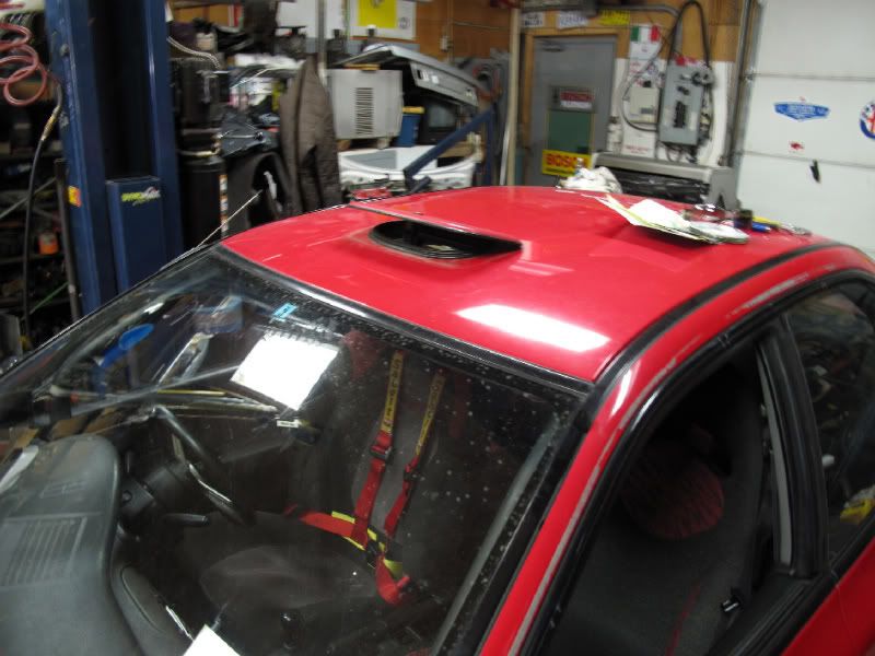

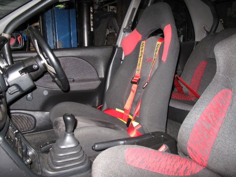

OEM Roof vent

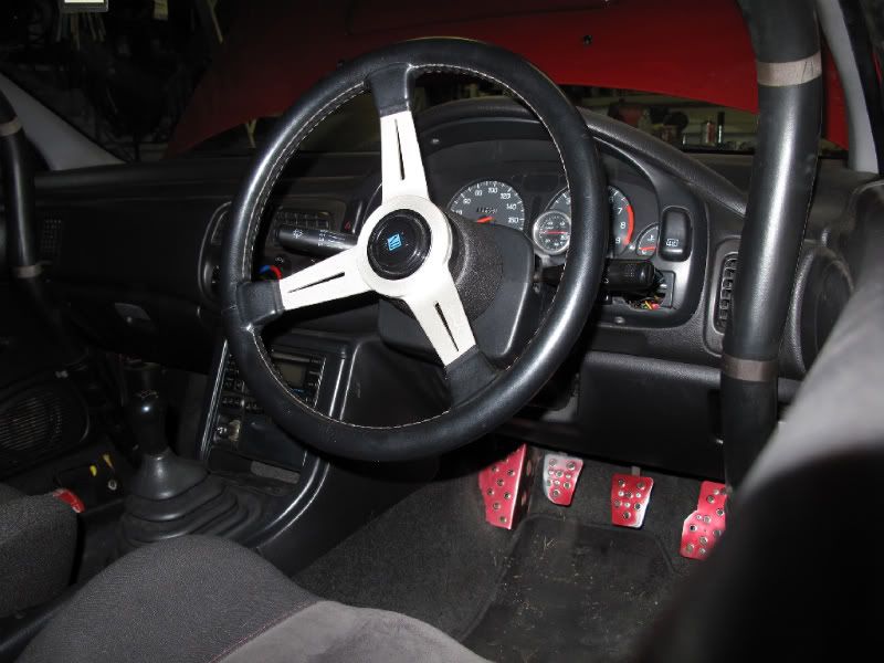

roll cage, light weight everything in the ra trim

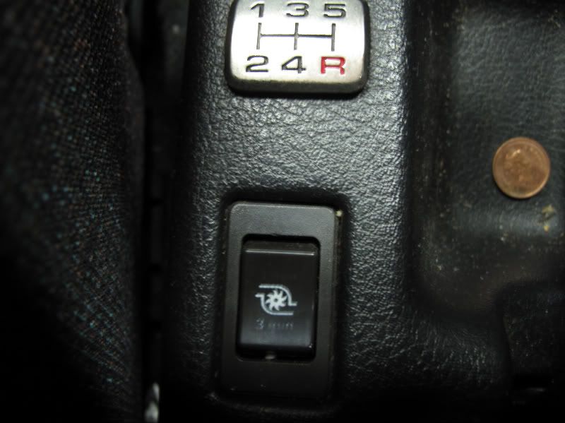

get this OEM turbo timer !! button up 1min, button down 3 min
EJ20 RA, TDO5, Water squirt intercooler, 5th injector.
& CLOSED DECK EJ20 BLOCK !!!

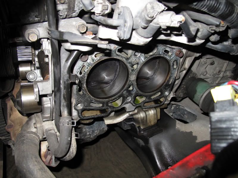

Why did you take the head off?
Re: Special Treat for Pep's @ Legacycentral
That's sick! OEM turbo timer! Damn.

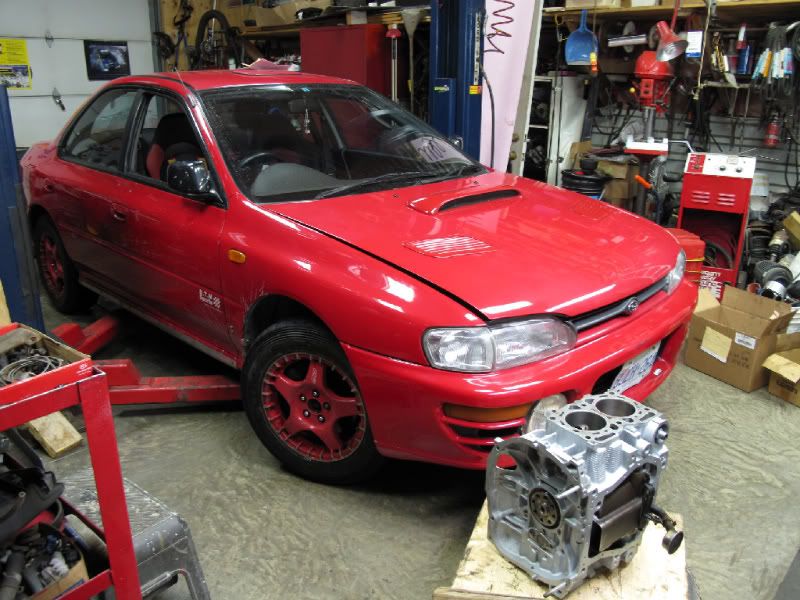

ciper the head is off becuse the car was running really ruff. i did a compresion test, cyc #4 was make 50psi & there is sparkley oil lol.
but the owner of it is selling the car, & the next owner is going to ask me to rebuild it.

but on a real note, me & my buddy got the car. what i have planed is drop a ej22t block in it & become a rally, auto cross, track, car.
this car was a rally car, it has skid plates under the car that are just amazing, and it has some crazy shocks from kyb (super rally special kyb ) something like that.
im going to use all my spare rust old just sitting around parts, and build a easy cheap fire breathing beast out of this. it should be fun first time trying to rally.

those cars are pretty cool..even the glass and hvac is a lightweight version!
what rims are those?

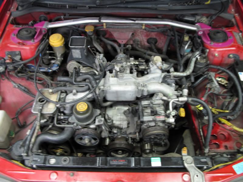

The 5th injector is stock? If so, it's quite interesting that Subaru would do that. Dry manifolds don't typically perform well wet. Maybe the 20g intake does? I typically cringe when people add a 5th injector for tuning a turbo kit or something like that.
Is that coolant expansion tank stock?

That's nice. I want a roll cage like that. Function yet still lets you use your doors and windows.
Very nice Nico, very nice.

93forestpearl wrote:The 5th injector is stock? If so, it's quite interesting that Subaru would do that. Dry manifolds don't typically perform well wet.
Thats how Subaru cheated. Those manifolds aren't uncommon. Standard cars listed them as a 'cold start injector' and with the regular ECU thats all it did. If you were lucky enough to get the real ECU that injector was tuned to add the necessary extra fuel.

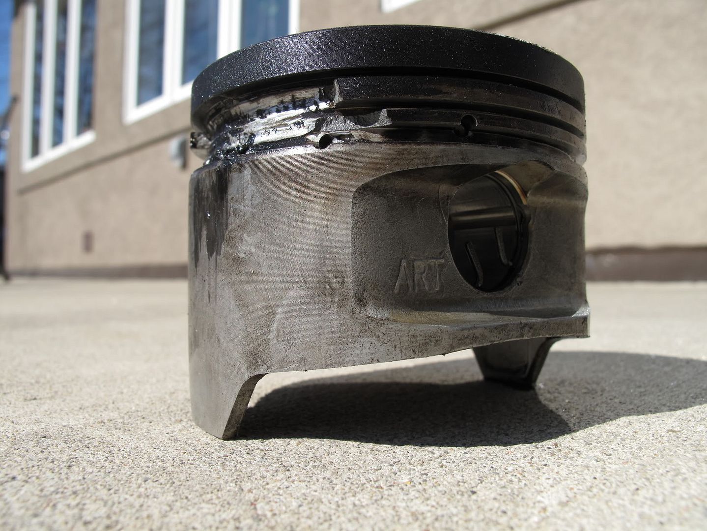

piston #4 (ART) ej20g RA, also if any one knows a part number so i can order a new one please let me know cuz i cant find anything on it and i want to rebuild this oem style. even part # for rings.
these are crazy anyone see twisted exhuste manifolds B4 ?
