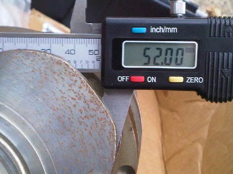

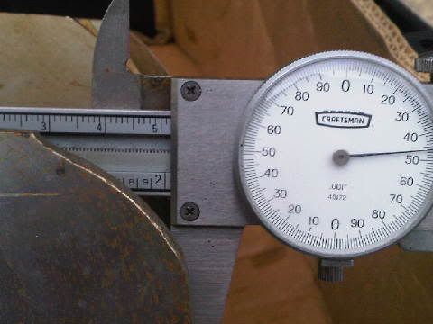

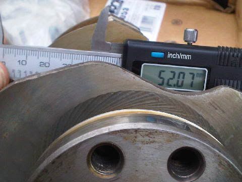

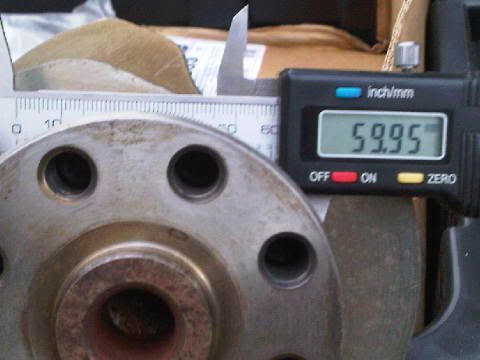

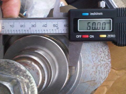

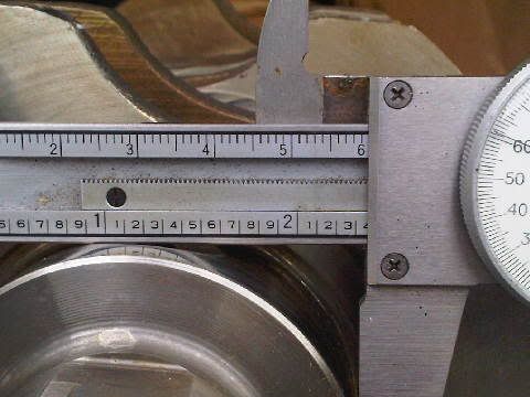

I got a spare crank from a Ej22t and 20G I had taken the Ej22t to my machinist buddy to measure it up andd it was with in spec ill get pics tonight, its at my parents house.
Don't know if your still interested in a crank but I got a link here to my photo bucket I got pics of measurements with old school callipers and new digital cheapos take a look.
My machine shop build sandrails out of older subaru engines and has tons laying around. I got a replacement crank, rods and pistons for $65 (although that's the friend price).
Mrbuttons wrote:Don't know if your still interested in a crank but I got a link here to my photo bucket I got pics of measurements with old school callipers and new digital cheapos take a look.
jamal wrote:My machine shop build sandrails out of older subaru engines and has tons laying around. I got a replacement crank, rods and pistons for $65 (although that's the friend price).
did you see all the ones on my photobucket? that's all i got i can get some of the journals to show you the lack of wear. also when i measured them up i got consistent measurements on the various journals which names escape me right now. oh and i haven't looked up what "in spec" measurement is but since they were all with in a few 1000th's i figure them to be A, O.K.
im on a computer now so ill post all picks i got now.
What can you tell by looking at them they have some discoloration all the way around on a few journals. Oil starvation? Or what? I didn't see any cracks and they are all smooth w/o any grooves.
It's the discoloration on the journals. It doesn't look bad, it's just normal wear I would assume. With all the other stuff I'm doing to the motor, I'm probably going to have to buy a new crank to stay with std sized bearings. I really don't want to put a crankshaft back in unless it's polished or new/near new condition.
You should just polish your own crank.Polishing should not take away enough to need new size bearings.Tolerances can be a tad loose without you ever knowing the difference,in fact too tight is more of a problem.
