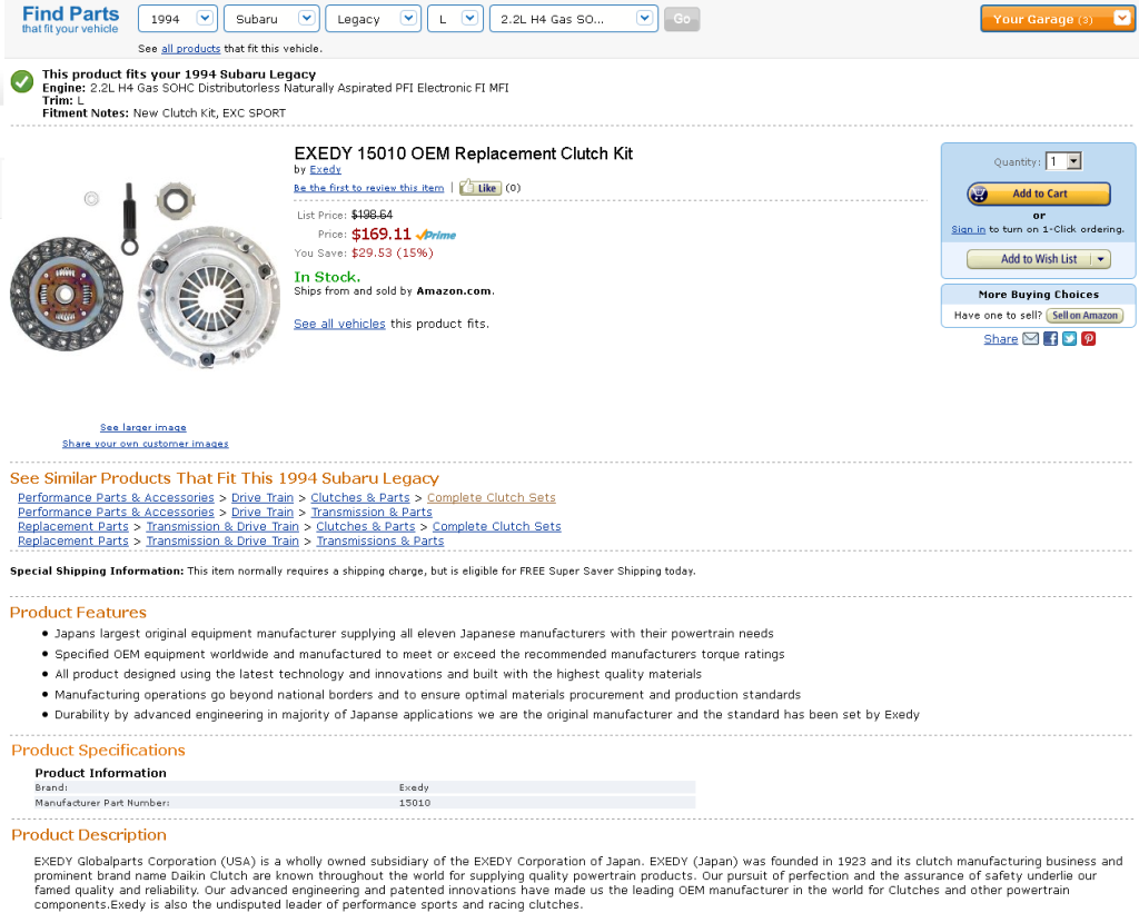

Does this look like a decent replacment for
the OEM clutch? My throwout bearing's on
it's last leg and I'm looking to replace it so
I figured it's time to replace the clutch too.
It has 218k on it and I'm pretty sure the lady
said it was the original clutch.
It says its fits a 94 Legacy L. Has anyone used
this kit before?
I've never replaced a clutch. Is this everything
I'll need to get it done in this kit?

That kit does not include the clips that connect the throwout bearing to the clutch fork. I'd suggest replacing them. The old clips may be good, but until you get in there, it's hard to know.

If you get the kit you pointed out, I would get both clips 2 & 5 just to have them. They shouldn't be much.
It looks like from the pic that the new kit has a new pilot bearing. I've heard of people having cracks in the clutch fork, but that may be something you just have to check when you take it apart.
I would recommend against resurfacing the flywheel. The non-turbo subaru clutch setup doesn't work well with a resurfaced flywheel since it changes the engagement point with the clutch. Others resurface them, so you'll just have to make that call. With that many miles on the engine, it would probably be a good idea to replace it. You may be able to find a low mileage Impreza flywheel or may be able to find a new one for not a lot of money.
