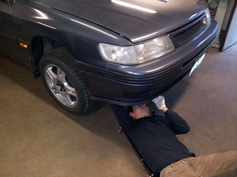

I know there are a couple threads about this, but I had to reattach mine after a scrape with a curb, so I thought I'd take some pictures.
So here we go:
I was screwing mine in to the bottom of the bumper, which in retrospect was not a great idea. But, having already made a bajillion holes on the first go around, I realized that it wasn't sustainable, and that the next time I damaged the lip the front bumper would be completely shot. So, solution...speed clips.

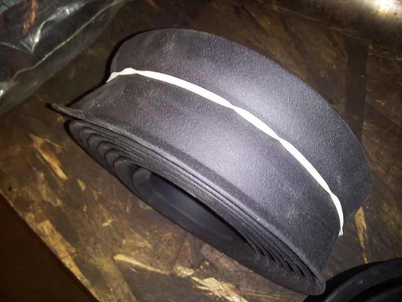

This is a role of the material I used, I could only find a suitable piece at Lowe's. Everything anymore is some kind of soft rubberized foam. This is still rubberized foam, but it's A LOT more firm. In any case, i'll try to get a upc or something.

Here's the first brace going on from the underside.
And the next corner piece going on. We had to cut reliefs, a couple small cut out triangles, at the corners.
Here's an outside view of how it's going on at this point.
Most of the underside just calls for small 6 or so inch braces. Two pre-drilled holes and bent up a little to add pressure.
Fine adjustment so it floats around evenly (ish). I'll have to heat gun it a tad to get a couple of the waves out.
Finished product (minus heatgunning).

Alright, as promised (months ago) here is the information about the garage door seal I used.
Purchased at Lowe's
UPC 04337407234
M-D Building Products
Hope that helps!
