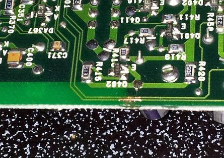

Here's the initial damage. Only the outer-most trace is actually broken, the inner trace that's scraped still works fine. Firstly you will want to ensure there is bare copper on either side of the break that you can solder to. A small screwdriver or razor rubbed GENTLY over the trace will scrape away the circuit board resin and expose the copper.

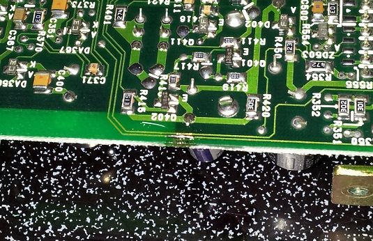

We will start by melting a smallish glob of solder onto the area to be repaired. This deposits a layer of flux, which will provide some tack for later on, as well as doing whatever else it is that flux does. Like I said, I'm not soldering expert :P
Use the soldering iron to just push the solder off the side of the board. It won't stick to anything at this point. As you can see, there is a nice goopy deposit all over the repair area.

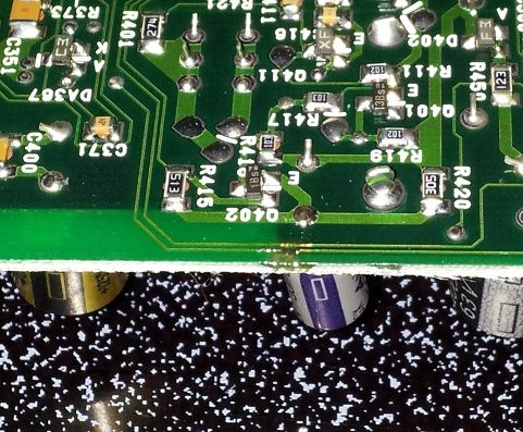

Now we will snip off a tiny strand of copper wire. This is what's gonna be soldered over the broken trace.

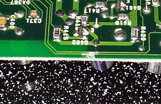

Place the wire over the break, making sure it's just the right length to lay on the exposed copper ends of the broken trace.

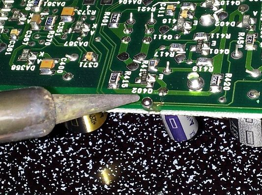

Now we attempt to solder that little wire. This part is what really takes some patience, a steady breathing rate, and more patience. You will almost definitely get way too much solder on there. You'll probably have to try and push excess solder off the side. On this repair specifically, this is very important because we have an exposed trace roughly 1mm away from the repair. You just want enough that the wire and the ends of the traces are silver with solder. I'm sure there's a cleaner way to do this, but as I mentioned this is demonstrating how someone with little soldering knowledge and is in a rush to drive their car again can perform a working fix without blowing up their car (that said, I'm not responsible if anything gets fried or blows up as a result of trying this :D )

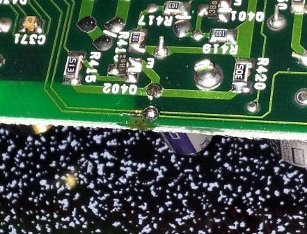

All finished. Throw it in and test it out. Worst case scenario is that you just wasted 10-30 minutes and still have a junk ECU board. In my case the CEL went away, and now I get to enjoy my Rob Tune without limp mode!
