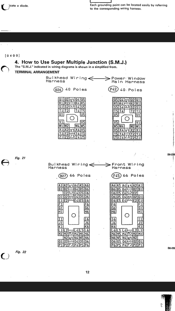

;-) there are 2 smj's in my harness, the smaller one seems to be for power windows, the bigger one seems ot have important engine running stuff running thru it and i need a pin out of it. i has 1-6 columns and a-p rows. thanks jim

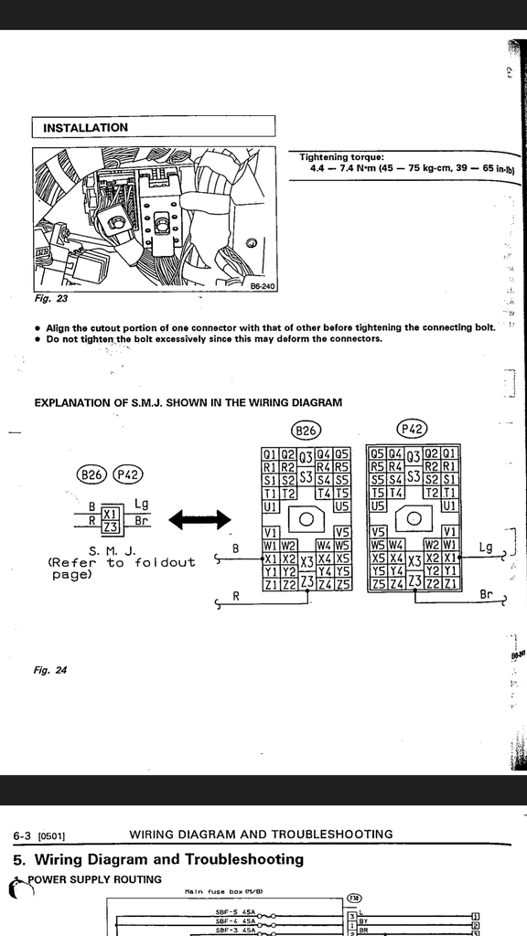

You won't find an exact pinout, but you can follow what wire leads to it and back out.
For example, ECU plug B58, pin 7, leads to SMJ plug B27, pin O5.
Everything you should need is in the electrical section of the FSM.

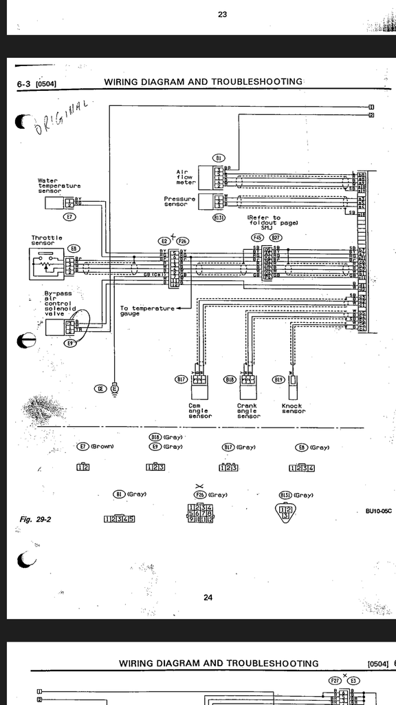

darn. i think i will cut all wires on both sides of both smj's, tape them together, and pull as many loose wires as i can. i also look a wire diagrams to see if i can figure out where inbound and outbound wires go. thanks guys.
