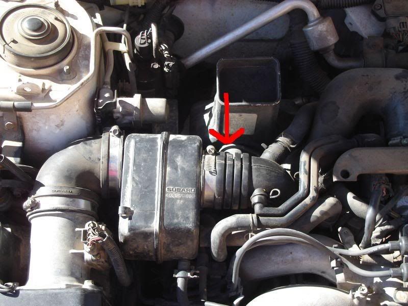

I am attempting to find a part of my intake that i cannot seem to locate in any oem places.I noticed that one of the rubber intake snorkels was torn when i was changing my air filter today, which i think might explain a sudden loss in power thru vaccum leak. It is the last one in from the air box that goes into the manifold. There is the elbow that goes from the MAF to the big plastic vaccum box, then from there to the manifold. I need the vaccum box to manifold snorkel. Can anyone help me out?

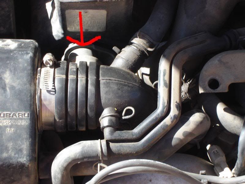

It is a turbo car. Here are a couple of pics of what i am in need of
There is a tear in the bottom part of the ribs and i think that may be part of why my performance has taken a drastic drop.

Those things are expsensive, good luck finding one.

Just remember: You're about to replace a used part with a used part.
Those elbows crack because they're made of plastic and next to a stupidly hot piece of metal. A used one will have been used under the same circumstances.
Its worth it to go to a new piece, or an aftermarket alternative (silicon hose elbow)

They are rubber and after heat exposure and years of driving they turn into what seems like plastic.
Search in the parts shed for "turbo inlet", more than one of us has them in good condition for less than new at the dealership but you are correct in that their are no aftermarket sources for this.
Also to anyone messing with this on your car: The heat gun is your friend, heat this all up before you yank on anything to help prevent cracking a marginal piece.

I cracked mine right under where the clamp covers. I just cleaned it all up and covered it with some high temp gastket silicone. works fine!

its cracked in the middle of the ribs right before the downward curve
