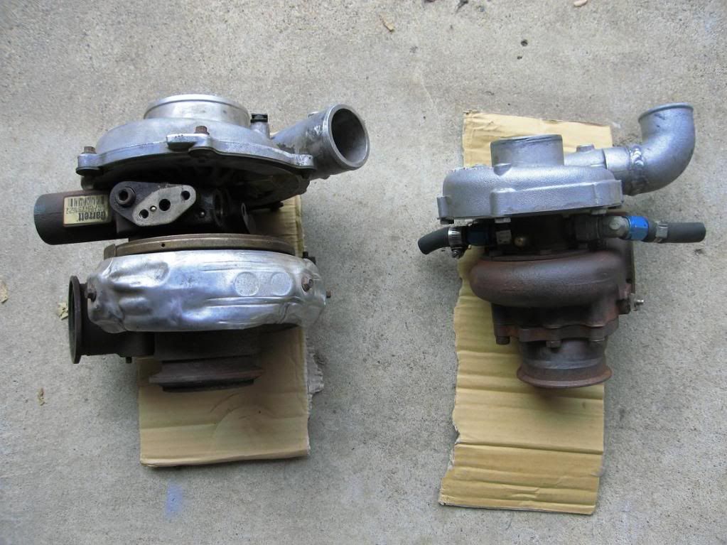

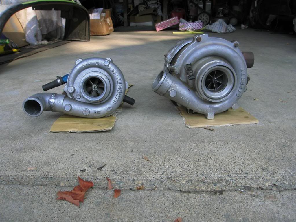

Got the turbo today. Its slightly larger.....
And yes it does fit. Even with AC, that I don't have.

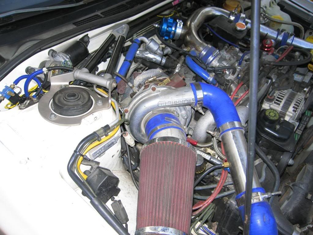

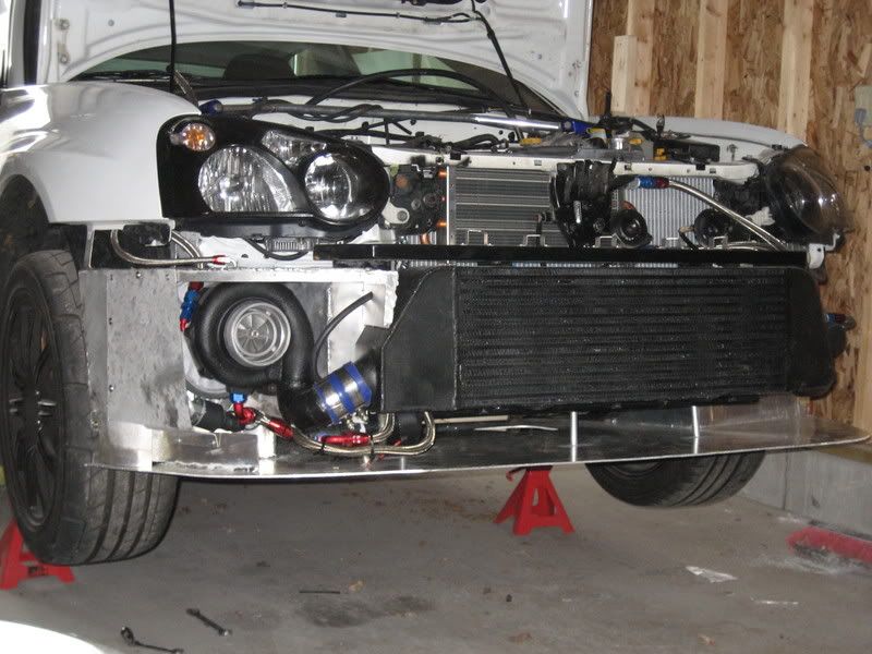

The white car isn't mine. Derek (whitelegacyguy) is the true pioneer with that turbo. I posted some video in the turbo section of it in action.
And by no means is it a paper weight, lol. With control of the vanes, the boost threshold is 2500 rpm, and 20 psi is easily attainable by 4000 rpm. Out of a GT37.
It comes down to a balance between boost and exhaust restriction in the end. In the video we posted he broke all four tires loose and was spinning them bouncing off the rev limiter...

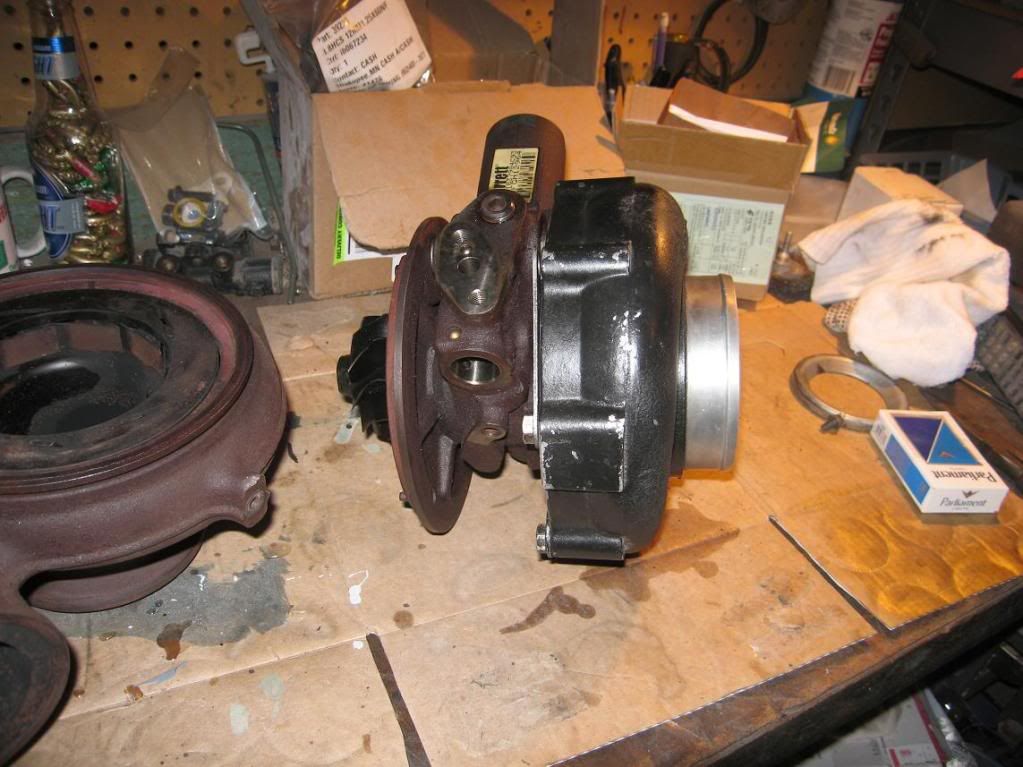

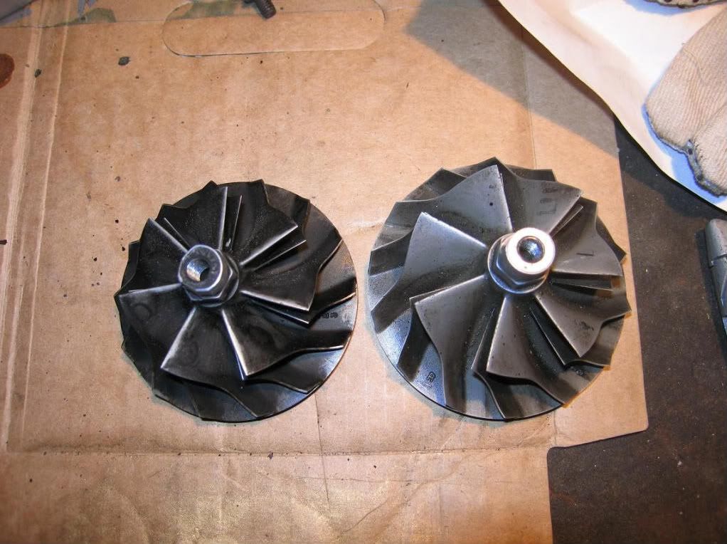

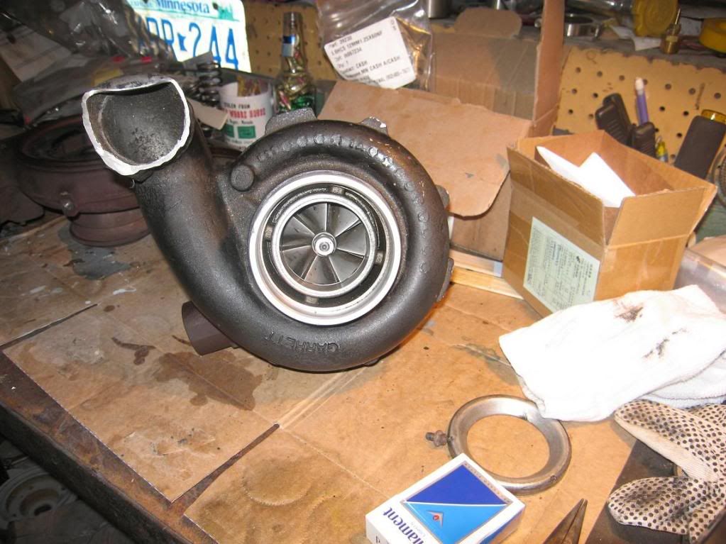

I'm going to a GT4088R compressor wheel, housing, and backing plate. The 40R is the new 20G, lol. My buddy has a munched 40R laying around so $100 and my old housing steps up the game a bit. 4.4mm on the inducer and about 6mm on the exducer. w00t
Also, 4 inch piping fits under the fender just fine. w00t

It needs some work, but the 40R compressor does interchange with the journal bearing counterparts. The housing mounting holes are further inward compared to the stock housing, so I need some allen head bolts and washers, or something.
Hopefully it doesn't surge too bad at low boost, but the additional 12 lb/min capability should make it worth it. Either way, it will sound pretty baddass at 3000 rpm, lol.

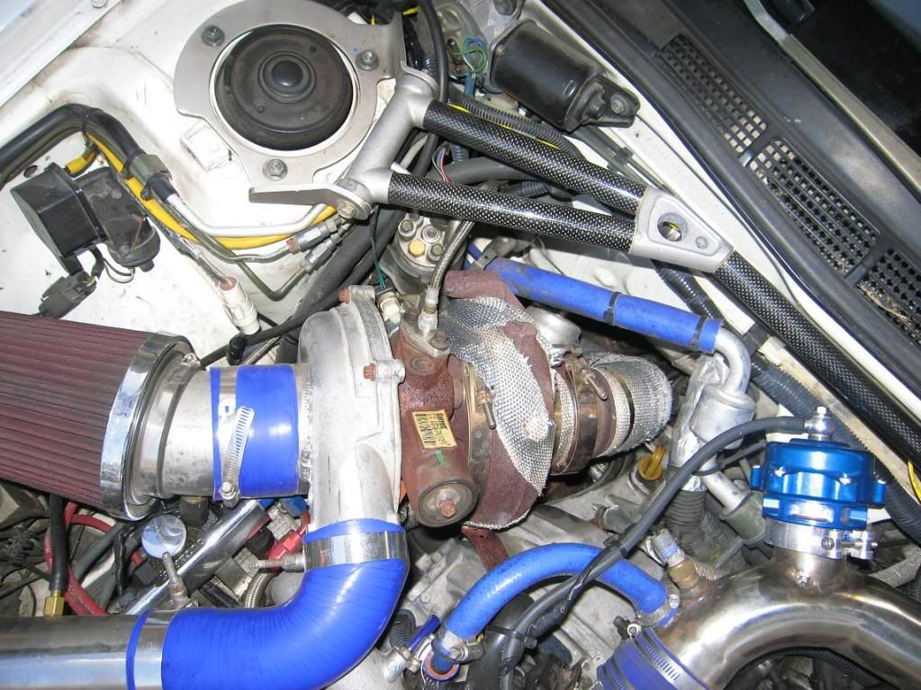

This was previously used here:
Is that where you're going to mount yours? Looks sick there.

lol, no foglight mounted turbos for me. It works very well, but its a pain in the ass. You need a sump tank below the turbo and a scavange pump to push the oil back up to the motor.
I'm using the variable geometry turbo so I don't have to go that route in order to get the response I'm looking for.

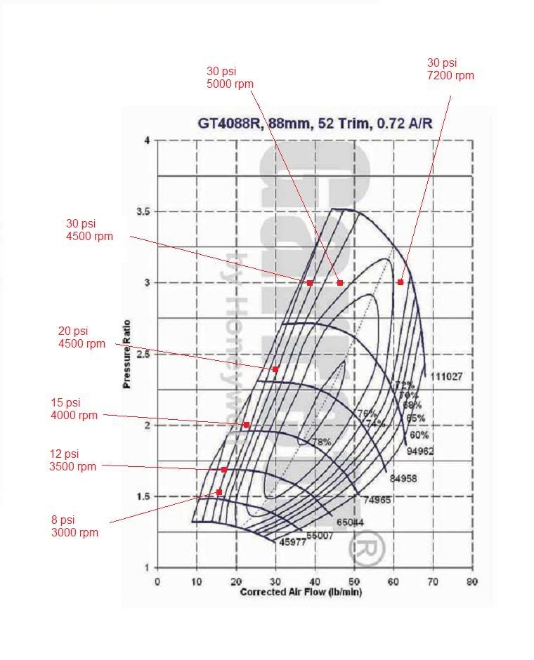

I did some basic plotting on the compressor map to see if this thing will be decent at lower flow rates or just want to surge all the time. It actually looks pretty good if I don't ask for too much boost down low, which would choke the motor on the exhaust side from the vanes being closed too far anyways.
The only area of concern is at 4500 rpm between 20 and 30 psi, where hot temperatures will cause a slightly a lower flow rate for a given pressure and shift the points to the left, near the surge line. I did all the calculations at 85 degrees F. 120 degrees could cause an issue, but the new setup might not even see such temperatures. Hopefully my cold air intake will help prevent too much hot air from the engine bay making it to the turbo.
In the end, this is only a rough estimate of how the compressor will perform in the real world. I don't actually know what the volumetric efficiency of the motor is at any given rpm and pressure. Same goes for the brake specific fuel consumption. I might not even need 30 psi to reach my target whp, so who knows. It's nice to get an idea of what will happen, but math doesn't always match real world testing.
You're definitely hugging that left side pretty good. You'll be making some heat due to the lower efficiencies, but like you said....real world doesn't always follow what the math predicts.

If I had a 2.5L, it would be perfect. The extra displacement would shift everything over about one efficiency band. It would have plenty of room for higher temps then.
From the looks of things, 4000-5000 rpm will be where I'm really flirting with surge. On Derek's car, the GT3782 compressor likes to surge around 3500 rpm. We simply backed the vanes off about 5% and the issue went away. This compressor wheel is slightly more efficient than the other wheel. 30 lb/min at 4500 rpm would be really nice though
I dunno. Its worth a shot at least. I could always put the smaller compressor back on if it doesn't work out, and hang on to it until I can sleeve the other block that I ripped the head bolt threads out of.
Yup, all you can do is try and see how it works out
