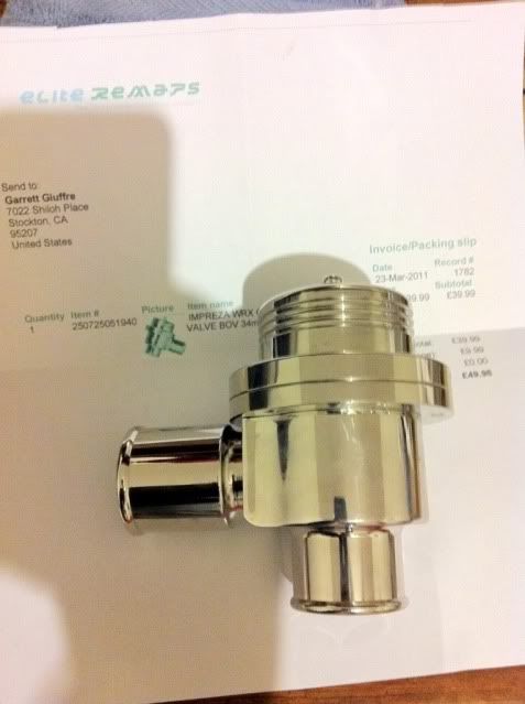

I have a aftermarket BPV, going back into the intake. I cant figure it out.
The car becomes so rich under WOT the car bogs

Is that an ebay bpv? I'd check to make sure its not floating open under load. I had a cheapo ebay bov at one point that would float open and do something similar. Swap in the factory one or a get a cheap Volvo/Saab one from a wrecking yard and see if it runs any better.

Good idea, let me swap another one and test it out!
